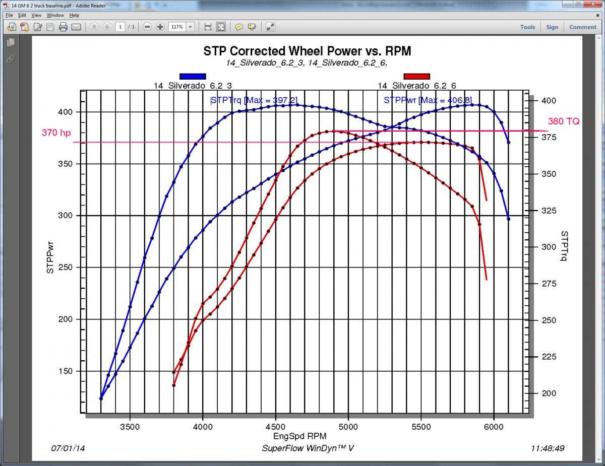

ok guys I did a little photoshop on the graph, assuming 4th gear is the accurate graph since the lines cross at 5252 I made some straight lines across to illustrate the HP and TQ figures.
I get 370 hp and 380 tq

The TQ and HP are scaled differently on the chart, that's why the lines don't cross at 5252, that's not an issue. The possible issue I see is about the top end surge it showed in 4th that didn't occur in 3rd, it makes me think the settings on the dyno were not the same between the runs.
This is along the same lines as to what I was thinking. Possibly two different graphs that had a scaling issue. Doesn't look like a gearing/transmission issue.

i think its possible that in 4th gear at the top of rpm the wheels might be doing near 110 mph and the speed limiter may have triggered.
What's the point of the chart then, if the graphs are scaled differently than the chart, then the Hp/TQ #'s we are seeing are not actual.
Speed limiter should have held the wheel speed and closed the throttle. Would have seen a massive dip in power output.
It's still usable, just not as nice. When looking at the torque curve, reference the numbers on the right side, when looking at the power curve, look a the numbers on the left side. While I prefer to have both lines scaled the same, people often scale them differently to make the chart look the way they want--GM even did it with the 6.2 http://gmpowertrain.com/2014_images/charts_lg/l86_chart.jpg . With the lines crossing at 5252 but the chart only going up to 5700 or so, it may have looked a bit more messy.

as for the debate here about the dyno, he agrees the 4th gear is the more accurate number, but they do both 4th and 3rd and I will be getting a new graph overlaid with the previous graph today!
They run 2 gears because as I suspected 4th gear would cause the factory speed limiter to kick in and not get a full rpm reading, so they have to disable the factory speed limiter for a 4th gear pull, most people will be doing a 3rd gear pull for a comparison.
he said these numbers would be consistent with a 20-21% drivetrain loss which is typical for a truck with heavier wheels and tires verses a corvette.
