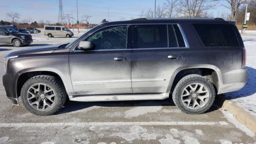

My last report, about 2 weeks ago, was about how my buffeting, booming and vibrating issues were resolved by GM.
Soon after, I brought my BFG K02s mounted on Sierra AT wheels to the dealership for road force balancing. Two came out sub 10lbs. One at 15lbs. One at 18lbs. Since I didn't buy them at the dealership, I had to take it as is. The dealership did report that LT tires also have a 15lb recommended limit.
The tires are awesome. Very slight hum at lower speeds only heard with the radio off. I also noticed that the buffeting returned, very mildly, only at 40mph. Can't wait to get some snow!
I rang up the fellow where I bought the K02s and made the drive out yesterday to see his Hunter Road force balancer. As a tire shop owner, he did emphasize that even 20lb is within spec for an lt tire. He acknowledged that our K2xx trucks may be sensitive. Long story short, we did a lot of spinning. Net result: 12lb, 10lb, 10lb and 9lb. Much less weight usedTwo were replaced as a courtesy. Buffeting is gone again.
I haven't heard any booming at all - I attribute that to the exhaust dampers.
Vibrations gone ever since rear axle was replaced.
Pic of my mounted K02s. (luckily, salt isn't active at -6°F!)
[fixed orientation]

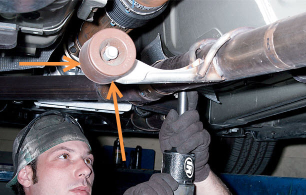

"I haven't heard any booming at all - I attribute that to the exhaust dampers. "

I think the physical exhaust system may have been the cause and not the stuff flowing inside of it. When I read 6 "exhaust dampers" on my work order, I assumed the ones shown in the pic below. Harmonic damper? Maybe the exhaust system was bouncing around in ways that it shouldn't have and that was as source of the boom and perhaps also buffeting? Unsure. I am sure that the boom is gone. This does fall in line with section D that Norcal SS just posted.

Yeah, we're talking about the same "boom". Low speed over bumps. Sounds like you're flicking a 12" subwoofer with your finger. It's gone!
Yea, that's it. OK, so those are the dampers that were installed on your vehicle? That definitely appears to be a highly engineered damper. And absolutely that is the kind of thing used to tune out a specific frequency or set of frequencies. So, if GM has gone so far as to engineer such a device, why TF have they not notified every owner who has complained about booming and had it installed! Jeez! What a bunch of a-holes if they are sitting on this.
That was a random picture from the Internet based on what I thought a dampener was and what I observed yesterday while my Yukon was in the air getting the K02s sorted out. I don't know if they added new dampeners or modified the existing ones. I didn't want to get directly underneath it with all the road juice dripping down!
