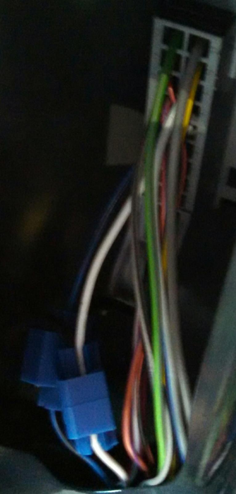

Thanks DJayx, yeah forgot to mention that - truck has factory Bose. I have heard of people tapping into the factory sub for signal or the passenger rear door. I am thinking I am going to pick up and AudioControl LC7i, that way I can plan for the future and add a 4Ch amp for the door speakers. To get my signal for my mono sub amp, would the best place to tap be the factory sub?
  • Replies 42
We just did my buddy's CTS and we unplugged factory sub and just used some male heat shrink connectors from there into an LOC then into his Alpine M500 hooked to a JL 8W3 in micro box so far so good
Here is wire tap at B pillar. Sorry for the delay.

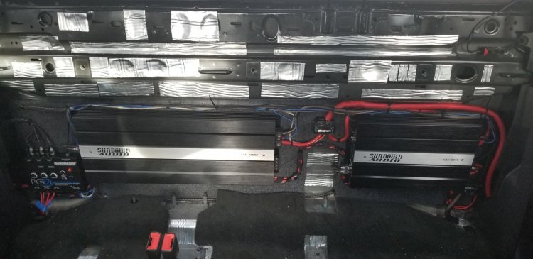

I installed two 12" shallow mounts on a dbl cab. It seems like the factory non Bose system lowers the low notes at high volumes to protect the cheap factory speakers. Has any one noticed that?
Fits perfectly under my back seat. I paid $1100 total after taxes and all. That's pricey for me but I love good music and honestly I wanted a premium product that was still classy. This system is dual 8" and comes in a VERY well made and ported box. I also paid for a digital El for it and a pro install which was all in that price. It also included a small rotating knob installed under the steering wheel that you can't tell is there and allows me to turn it down or up as wanted. The sound will definitely surprise you. Back in the day I had dual 10" subs and this sounds better than those overall. Maybe 15 yrs of tech growth has helped that.
The box fits absolutely perfectly under the back seat so no mounting is needed. With the amp built in there's just one big plug and two rca jacks. I can unplug and remove in under 10 seconds and still have complete functionality of that room. Was a great buy.
Has anyone addressed the issue of the factory stereo reducing the bass input into the aftermarket amp as the volume is increased and if how did you eliminate it?
Also for those of you that have replaced the door speakers and added an amp to run them how did you deal with the door chime volume being amplified.
At first I plan to just add 2 JL 10s and an amp and get my signal from the rear door speakers so I don't have to deal with the chimes. If later I decide to replace the factory speakers and add a 4 channel amp I will probably just use the rear speaker leads for the signal input and just use some rca Y adaptors for the 4 channel inputs, Run new speaker wires to all 4 doors and leave the dash speakers connected simply for the chimes that way the chimes won't be amplified. Of course using just the rear speaker outputs and the Y adaptors will eliminate the ability to fade front to back but I could simply adjust the gains to balance out the volume front to rear.
