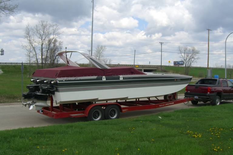

Ben- Your 6.2 has as much torque as the old 8.1 its just at 4000 rpms. It will tow the 10,000 just stay at 65or less. I used to tow my Chris Cat with an Avalanche 2500 the boat weighs 11,000 lbs and I had the 4.10 gears. Got 8.5-9 mpg pulling that. My Duramax really pulls it like its not there.
I think you made the right choice with the 6.2 its a great engine.
Avalon
