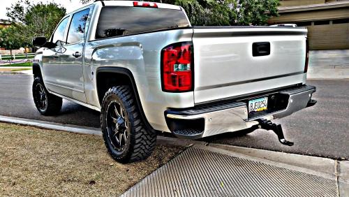

You have two economical options
1. You have them scuffed as much as possible and then paint them(which the will chip sooner or later) but you can put xpel clear film on the front bumper to prevent that(which is also self-healing)
2. You can have them acid washed and it will strip off all the chrome and then paint them, which holds up a ton better but is more expensive.
I went with choice number 1 and have had no chips since February

Shit man that looks great! The look I am after.
