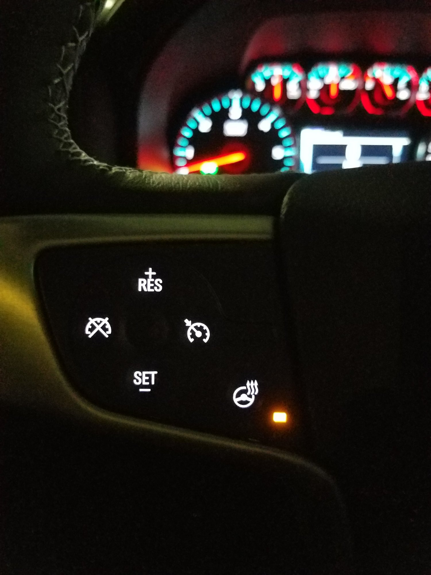

Just got mine installed.  Heat works, but the light won't come on.  At this point, I cant tell if the switch works, but the light doesn't or that the heat is always on.  Going to let it cool down for an hour or so, start it up and NOT push the button to see what happens.   Any suggestions?
Edited by Pope
Figured it out.  Anyone familiar with Garage Logic?  Radio show in Twin Cities MN.  50/50/90 rule.  If you have a 50/50 shot at getting it right, 90% of the time you'll be wrong.  Pictured a few posts back was my exact plug setups, but the plugs do fit, just in the opposite polarity.  Current goes through the heating element first, then stops at the switch.  Switch doesn't' do anything as expected.  I pulled the wires out and switched them.  Bingo!  Taped it up and working great!
