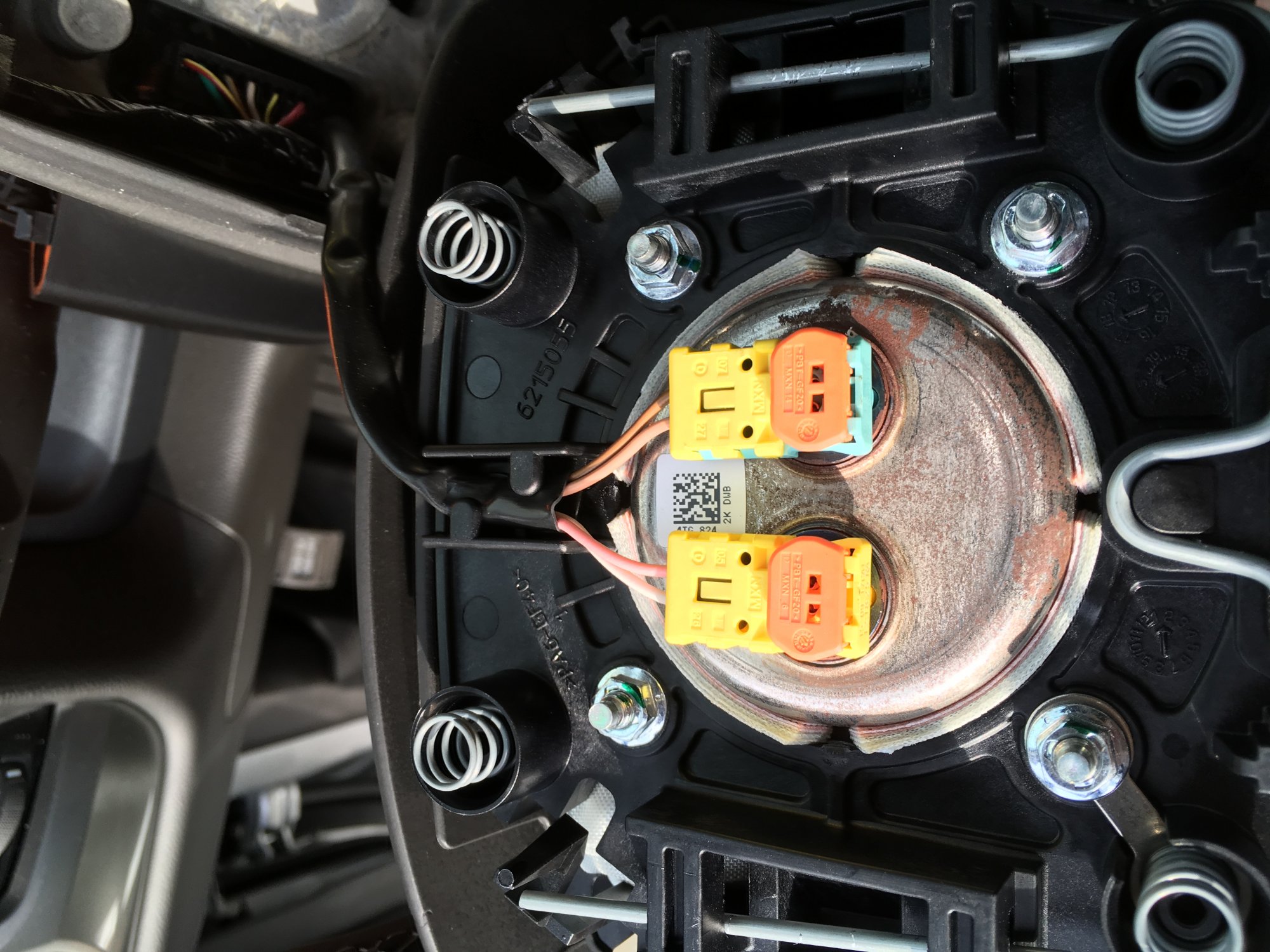

I’d like to thank @TinkeringFox for his video and @pgamboa for his help. I did the heated wheel mod after work,  and I’m very excited to have it ready for the cold winter. For those who have the heated wheel, do you notice whether the wheel maintains co start heat or cycles a little bit. It might just be imagining things.   I did want to add a few things. The steering wheel nut on my truck was 21 mm in size. I also wanted to,post a pic of the airbag with the two sensors. Overall, a very nice mod if you’re willing.
ps  If you’re thinking of this mod, look at the part numbers @pgamboa posted in an earlier thread. The wheel has changed in number.
Awesome! That 21mm socket got me too. That size is not normally found in a socket set. Had to put the airbag back on and run to the store to get one. LOL!
