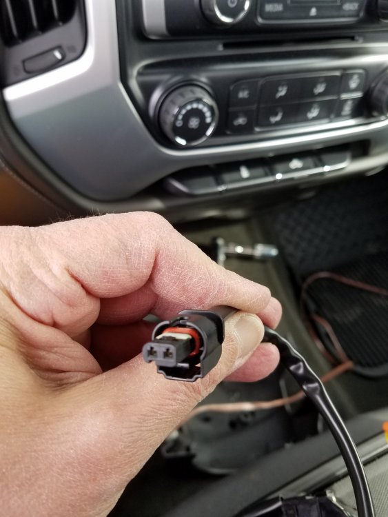

On 12/21/2016 at 10:44 AM, pgamboa said:
Here is a better picture with the connector disconnected.
My clock spring doesn't look like yours. Where do I get a connector to fit this? 2018 Sierra 1500
I make the 2018 harness to mate with that clock spring. PM me to order. It’s $35.

I have a connector present for heated steering in my 2018 LT Silverado but there is a connector plugged into it running up to the clock spring. I dont have heated steering wheel equipped.
Edited by BackRoadZ1
That’s not the one. If I recall... that connector is for the shift lever or the turn signal lever.

Just FYI....on my 2016, I had the fuse in place, but the connector was not live.  I was missing a connection between the two blocks and had to run a wire. Yours may be hot....but it really seems to be hit or miss.  My truck is an LTZ with heated/cooled leather, memory seats, almost every option other then sensors and sunroof and my connector was not hot.

I read through a bunch of this thread and saw that.  I will have to check today and see if the connector is hot..  I already looked and the connector is there....
I do make the 2018 supplement harness if your plug is not hot. For 2018, GM changed the connector from the clock spring.
Let me know.

So I have a new clock spring (23381964) for my 2018 and apparently won’t connect to my truck Phil. Does your harness plug into this “old” clock spring and into my 2018?
Let me know.
It appears that my under dash connector is not hot. So what now Phil?
You buy by supplement harness and follow my video.
PM me to order.
