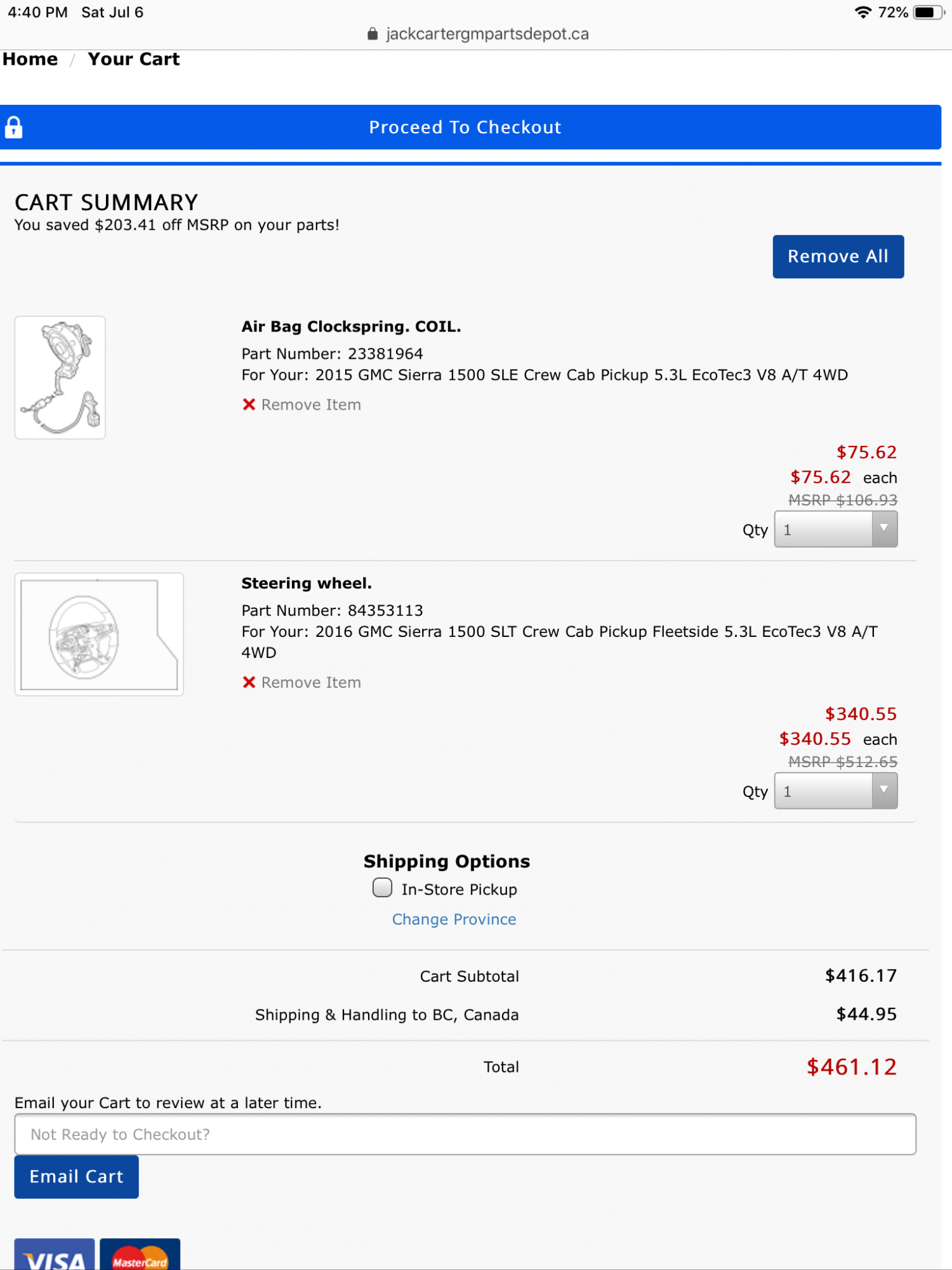

Thinking of doing this mod want to make sure I get the right parts here is what I looked up
