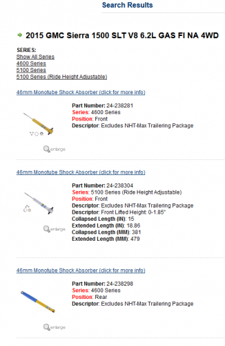

Is anyone aware of a replacement Bilstein (or other brand) shock that will work with the NHT Max Tow package?
From everything I can find so far, Bilstein specifically excludes support for it.
Those shocks will bolt on to the NHT truck, they might not have enough dampening to control the rear spring on the NHT tho.
Per this thread, a few users have bilsteins on the NHT equipped trucks.
