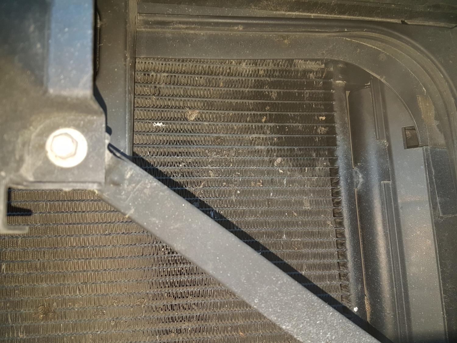

I have a 2015 GMC Sierra and am experiencing the same issue, white steam/vapor coming out of the front grill when coming to a stop. No leaks and temp. gauge is normal. Brought it back to the Dealer and said the same thing that it is most likely moisture burning off of the radiator or other hot components. If this was true, this should be happening with all owners when it rains or snows. Im still not convinced. Has anyone actually seen the location of where the steam/vapor is being generated from before it comes out of the front grill? Usually on the right side of the grill as well.
Mine has done it since the day I bought it. I thought I was over heating at first when I saw the steam coming up from the front of the hood. Found out it's the water on the hood area that goes forward onto the radiator top, etc that creates the steam.
Could you explain your findings better. How does the water from the outside of the hood get on the radiator top?
Would"nt it just roll off the hood?
Best I could tell was it just rolled under the end of the hood, down over the plastic cover and onto the hot metallic fins, etc of the radiator. Never saw any steam while travelling, only either stopped or parked after driving in rain. Hard to explain, but I will say that it did not have any odor that would indicate coolant, etc.
My 2015 Sierra does this as well. If this was a "normal" occurrence with the late model Sierra/ Silverado, then why do only some have this issue with vapor/steam coming out of the right front grill area during a stop? If water is collecting in a certain area (right side) due to the front end design, then all trucks should have this condition. My question is, what is on the passenger side near the radiator that could be burning off the water, thus causing steam? The only way you could see the steam where it originates from is to remove the plastic covering that covers the radiator/transmission cooler area. Some are saying that it does this in dry weather as well. Very suspicious. Is the radiator cap in this area? Could it be venting or defective covers? Any GM reps on this site with an input?
Normal, moisture is contacting a warm or hot surface, hood, radiator etc. I really notice this coming out of car wash.

Mine does it too... does it the most in snow, I figure it just catches enough in the radiator to steam as it evaporates.
I understand why it may happen when it's raining or snowing, but does yours do it too when it's dry out? When I shot that video, there was no precipitation, and it was after about a 20-30 min drive. I think any water that could've been there should've evaporated after that time.
Mine has done it dry. The first time I noticed it was cold outside and I thought I maybe had an exhaust leak by the manifold or something like that, but I haven't seen it happen in several months now.
Caught me by surprise a couple times. I smelled just straight steam, no anti-freeze.
x2 When in doubt, use your sniffer.
I don't know, seems like a leak to me... I will be observing the coolant level for a few more days, but I am pretty sure I will have to get that checked out at the dealership.
