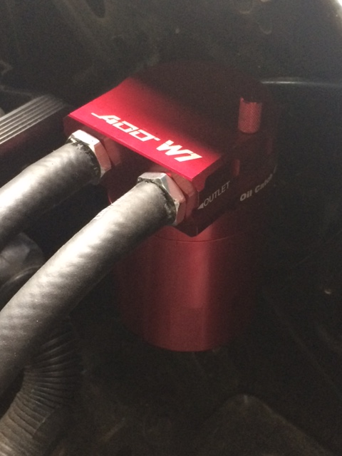

got to install mine about aweek ago, I bolted it straight to the inner fender, How hot do these things get, mine got so hot you cant even touch it, is it suppose to be like that

It will approximate your oil temperature. A little less, but it's getting it's pass through air right off the valley of your engine.

yeah I guess that makes since, what ever the oil temp is, is how hot the catch can will be, I should of known that, lol thanks

This is why it doesn't really matter where you mount it in your engine bay to try to take advantage of cooler spots. The internal temperature of the can will still get as hot as the oil temp and crankcase gases that it's mostly a futile effort to try to locate it in cool zones.
The theory makes sense though, it's the execution that doesn't. I could see if you built some type of refrigeration box for the can that tries to dramatically cool it down, that might make a difference in what the can catches.

Has anyone tried to incorperTe stainless steel braided lines? I just ordered the add w1. still waiting on the delivery of my truck...

Does anyone catch can make a hissing sound?
Yeah, it's more than likely from your hoses partially collapsing. I'm used to it now
Would transmission cooler hose cut down on the hiss?
I used transmission line and havent heard any noise. Been on a few months, dont even know its there.
I tried fuel line and pcv line both had a suction sound had to go to hydraulic hose to stop the sound its quite now. Need to get flexible hydraulic hose it has a cloth like coating the rubber coat is very stiff will work just hard to work with.
