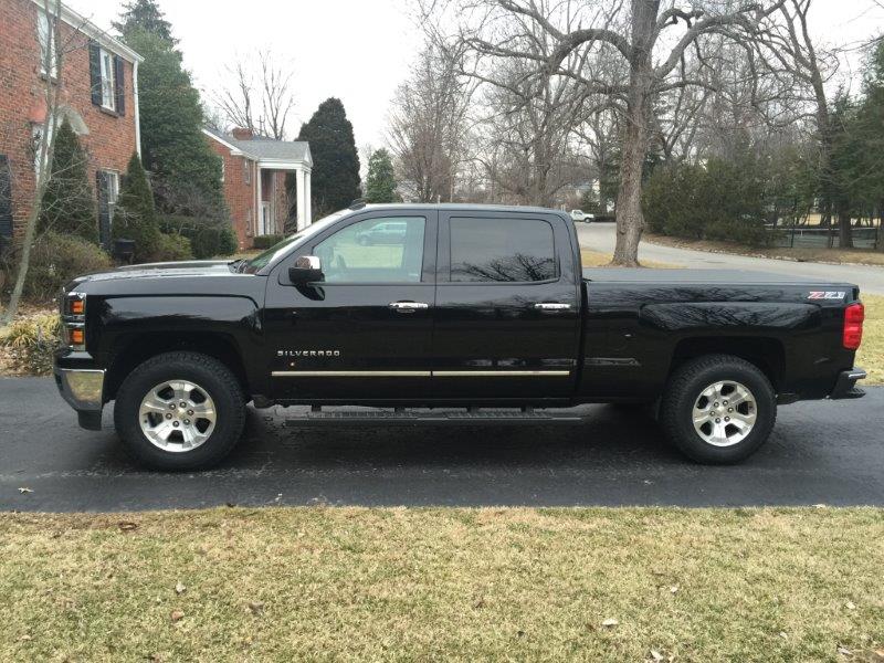

Got my fronts on today. I went with the 1.25 setting. Truck measures 1 inch rake now. 38 front 39 rear. This is perfect as I tow. My timbren have 1 inch before they engage so when I hook up my TT should stay nice and level. Overall really happy with my choice. I have had Bilstein before on my 2011 but just continue to love them. I think the truck rides some much nicer. I think an underrated part of this upgrade is body roll. I have always been impressed how they can help while cornering. I also feel it provides a more stable platform while towing as well.
I considered doing the job myself but glad I found a local shop. I used a guy local who specializes in big rigs. He showed me his spring compressor used to compress dump truck components sitting next to 2 city of Milwaukee Salt trucks in for service. I laughed and felt confident he was capable for my tiny 1500. $200.00 out the door with alignment.
FYI-He also said alignment was off from the factory and not just a little bit either. My truck only has 6,000 miles on it. Just so happens he also drives a 14 Silverado and said his alignment was off from the factory as well.
