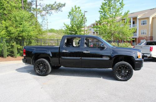

Someone must have pics of 33's on a 4" lift to help....
Here's a picture of my 2012 Denali with 33's and a 4" CST Suspension lift.
