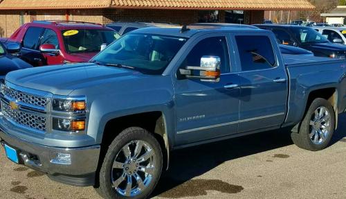

Level kit + 22" wheels.
Im running a 305/40/22 all terrain tires and have no lift. No issues or rubbing unless you fully lock the steering wheel to either side.
