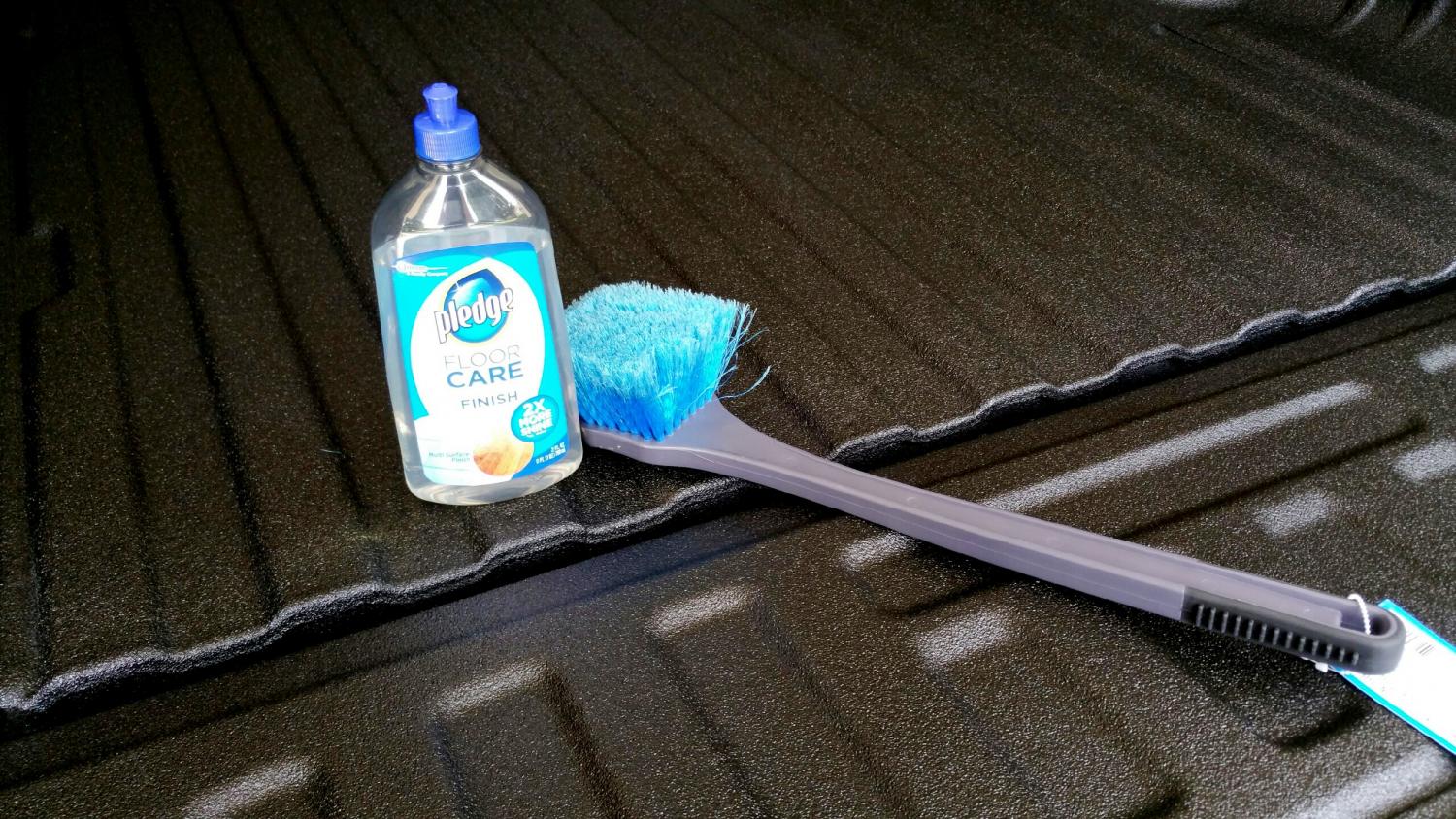

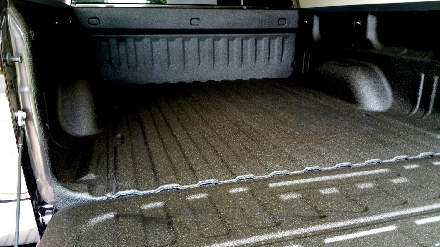

If your Line-X is looking flat and dull...
If your bedliner is looking a little old and weather-beaten, try some of this Pledge Floor Care Finish. (Formerly "Future Floor Wax".)
I really liked the way the Line-X looked for the first few months I had it. Then it started getting a little dull.
Not slick to walk on at all and gave it a little refresh.
We'll see how it stands up to the Auto-Wash.
Picture shows dull side vs. Pledge side....
Looks good, I wonder how long it will last for. also wonder how well it will work on black plastic.
There are a lot of guys who use this on black/gray plastic on the Detailer's Forums. Also, the guys on the Avalance Forum use it on all that tons of plastic cladding they have on their vehicles.
I thought it would be worth a try.
(I actually read about guys using it on an entire car's paint finish! I ain't tryin' that! ) :nonod::lol:
I've read of many RV'ers using floor wax on exterior of faded RVs. It looks good for a long while (reported several years) until it builds up too thick and begins flaking off. Then, they have to strip it off and start over with application.
Your Line-X looks great in photo, just be aware of buildup as you reapply over time.

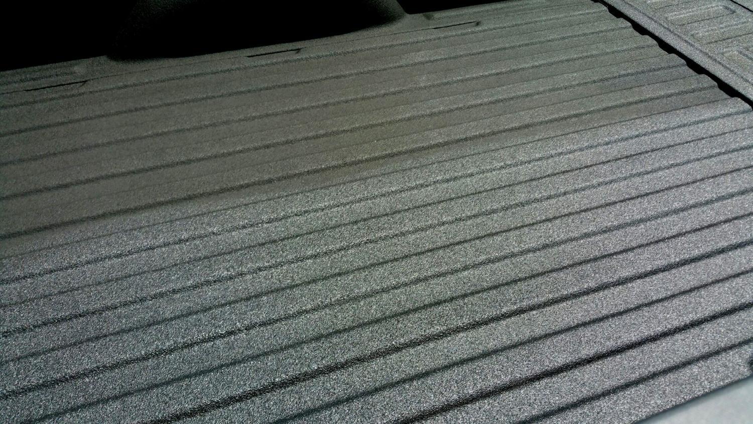

Yeah, not planning to use it too much. As it gets dull from carwashes, etc. I'll probably give it another shot, maybe every few months.
Here's another shot. Looks like it did when I picked it up from Line-X!
