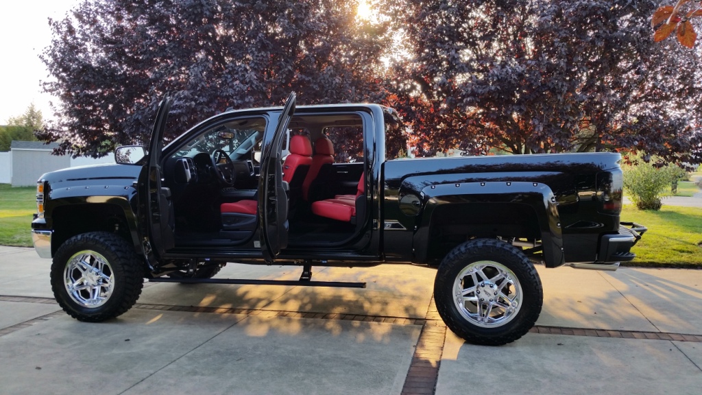

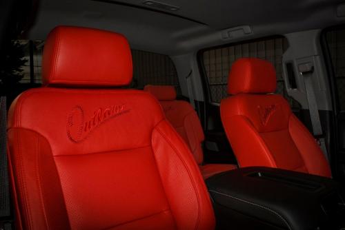

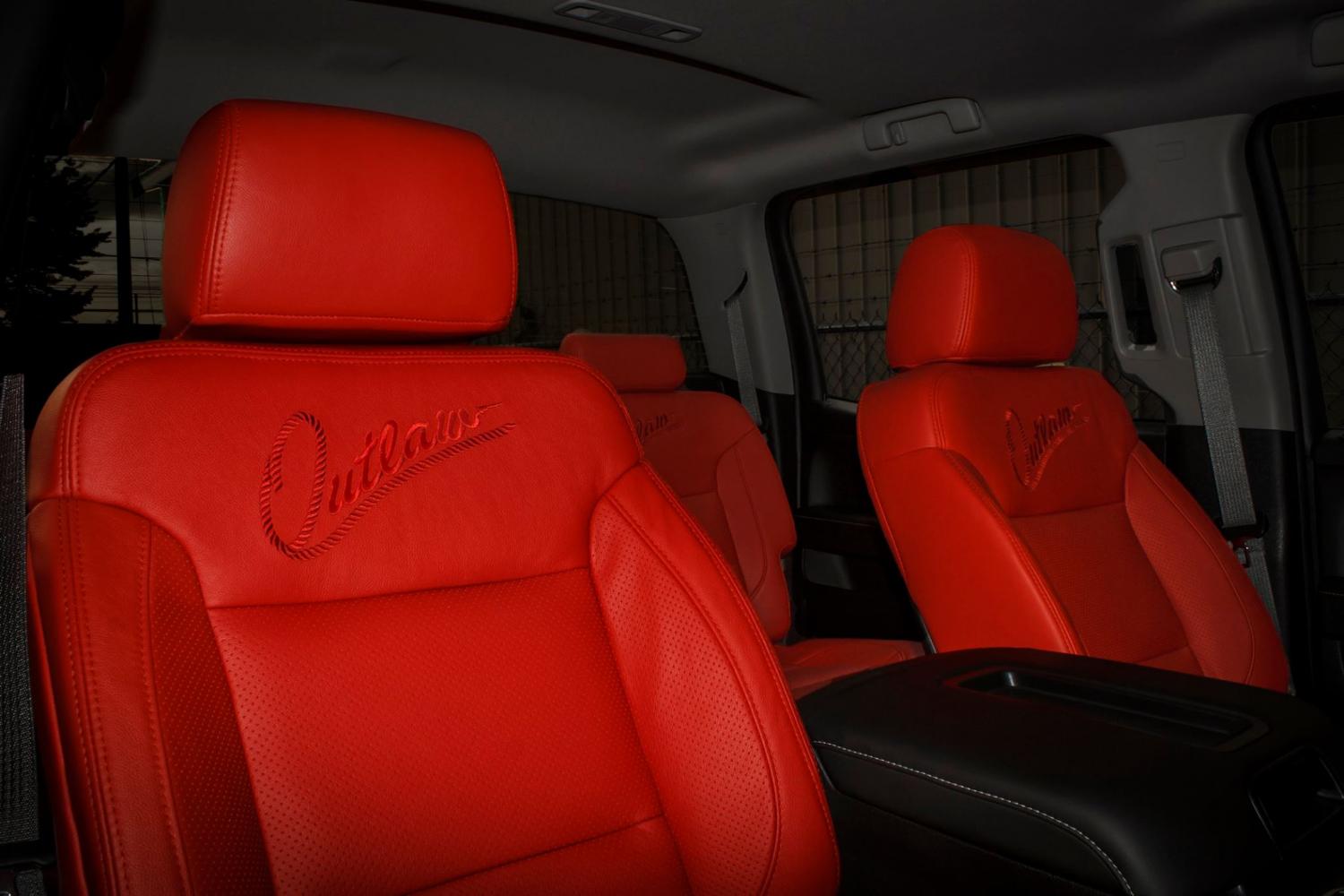

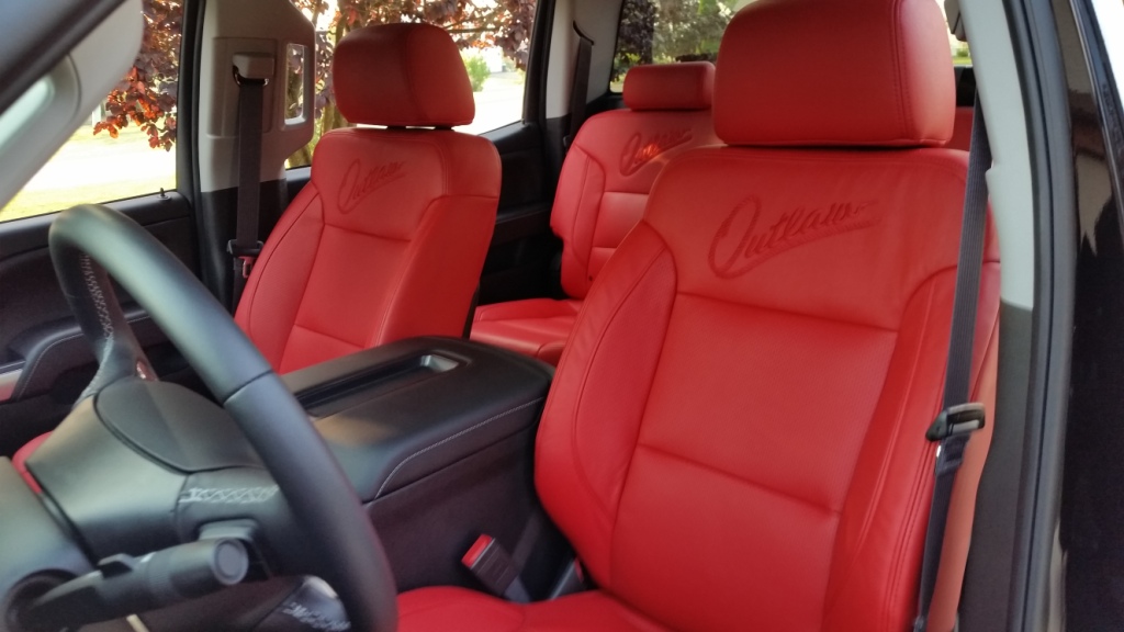

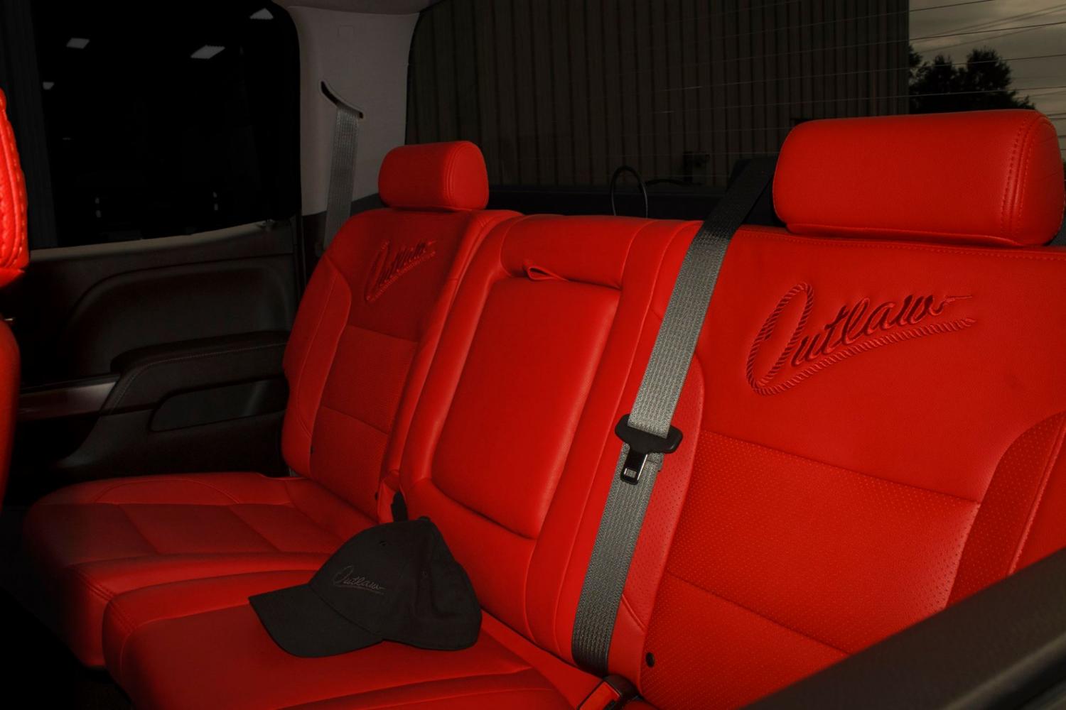

To follow up as I threw my two sense in early in the conversation. I followed through and chose Roadwire. This is a show truck so I needed something that was going to pop went with 600 Red so it has a similar look to the new Corvette adrenaline red. My local shop Keystone Styling did the install and in order to promote the shop we did the Outlaw custom embroidery which is one of the series of conversion trucks that they build. Perforated centers, all red stiching, just needed it clean like the outside of my truck. More photos available on my instagram @tstehle07 or their website www.keystone-styling.com
Wow, that sure is red. You could get away with murder with that interior.
