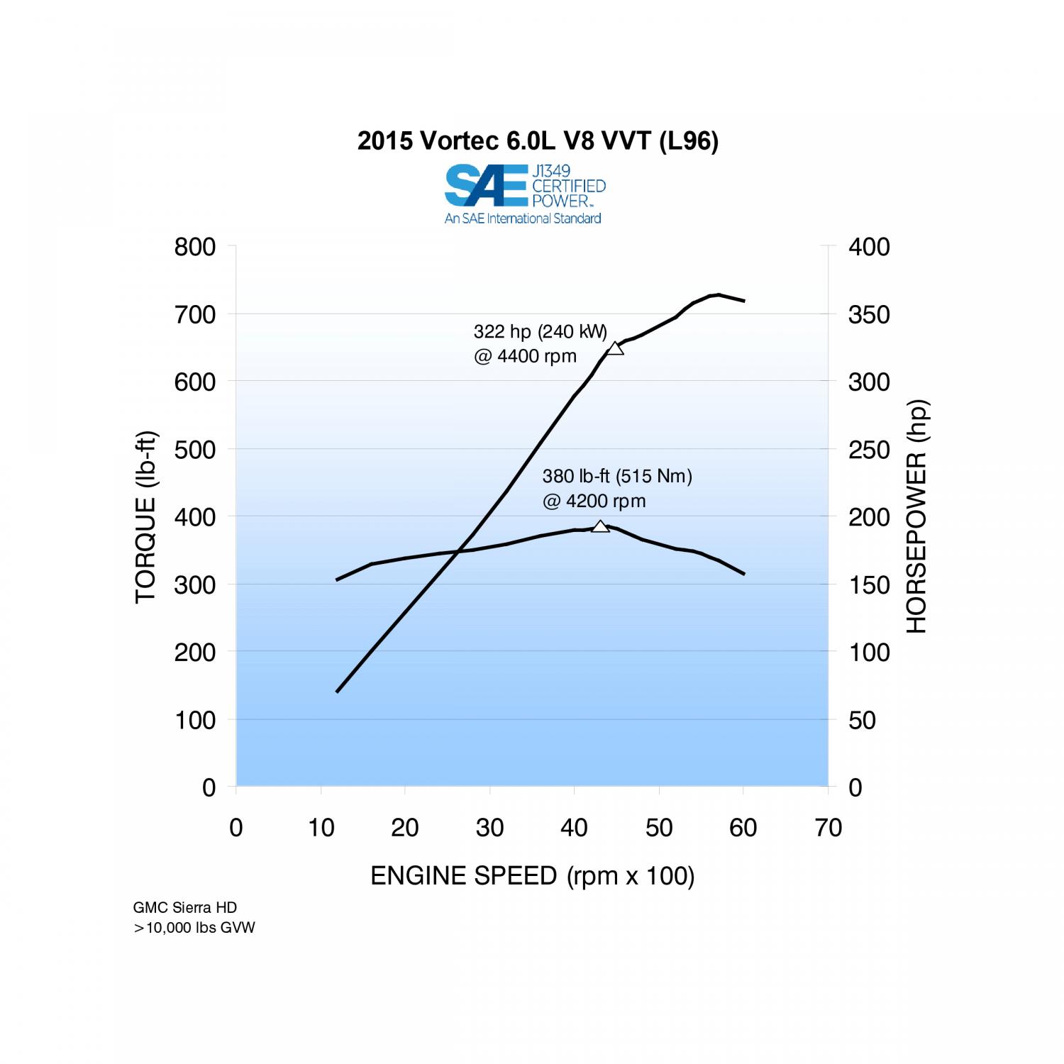

I think it is a product of what you are running up to. If you run up to the 6's in RPM, you have less torque available than at 2000 RPM according to GM's own charts. It is the absolute rotational inertia that you are depending on at that point. Even if dropping to 3500, there is easily 50+ more lb of stock torque available at 3500 than at 6000 RPM. Even at 5000 RPM, available torque has dropped off to below 3500 RPM levels. Almost down to 2000 RPM levels. There is a substantive drop off of available torque after reaching peak at 4200. When you run up to those RPM levels and then shift, the motor does not have an instantaneous jump in torque either. There will be a slight delay for the motor to settle on power at a new RPM. This chart from the up fitter version of the L96, but torque curve is identical to L96 in the 2500-3500 pickups. The chassis up fitter version just has a lower HP rating.
So if I shift at 4200 it should do better then? why wouldn't the transmission automatically shift at the best time when in tow haul mode?
Programming. Tune it and change the shift points. Even on heavy commercial truck automatics and automated manual transmissions, the shift points are generic and not always ideal for every application. Unfortunately, the pickup OEM's are not as generous with user defined variables that can be adjusted by the dealer like the commercial truck OEM's allow. In a typical heavy commercial truck, I have over 250 variables I can have the dealer select and adjust at my whim, several of them which are transmission related. The pickup OEM's have their particular desires in mind when they set the shift point programming the way they do. Some of it is legit, in that they are concerned with transmission protection. Some of it comes from more of a nanny mentality and the perception that they need to protect everyone from themselves.
I never implied shifting AT 4200, I only stated that racking up the RPM's you are claiming takes it well outside the efficient band of the motor. I know this is some what confusing. I am viewing it thru over 5 million miles of commercial truck driving. One has to learn their motor and the band it operates best. The charts gives a starting point that anyone should refer to right out of the gate. From there, they need to find that ideal range that Unfortunately also with this motor, the torque curve is not nearly as flat across an RPM band as is ideal, but even with that, there is really no appreciable reason to take the RPM's any higher than necessary, so that on the RPM drop with a gear shift, the torque at the new RPM is above 90% of total available torque. Over speeding the motor out side the efficient RPM range can have more negatives than any supposed positives, shifting included.
what doesn't make sense to me is why shouldn't I be maintaining speed after shifting if the torque is higher at those rpms? I don't remember the exact rpms I was in but I know I'm close.
Because despite what some say horse power matters, the most power is where horse power and torque max out which I believe is at 4400rpm. You need the motor to rev past that point to prepare for the next shift or you would be way under the curve.
The real thrufh is that the stock tuning sucks and most of the time the throttle body isn't even 100% open. Tune a 6.0 and you would be amazed at what the stock motors is capable of with good trans tuning and 100% power.
Why do you guys keep saying 6,000 rpm? The motor defuels before 6,000rpm, you guys have not spun the motor that fast.
you are right. it was around 5000 not 6000. I had to watch the tfl video again because my truck is still getting the oil leak fixed. I would be scared to tune the truck and screw it up even more and have it not covered under warranty.
