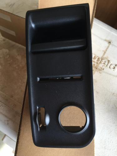

I also have purchased a P3 and I intend top mount it in the dash in the same place as where the OE IBC would be (except my dash has the coin/storage pocket instead of the IBC). I'll do a write-up and pictures as I do the mod... I have a replacement dash piece on order ($20 is all!) for the switch panel (4x4 control, headlights, and coin/storage pocket). Surprisingly, the P3 will fit in the pocket if you trim out the left side of the pocket... it will go in as far as the manual lever pivot on the bottom at the same time that it bottoms in the pocket. I'll then use a urethane foam to make a custom fit foam insert and will likely use at least one of the screw holes in the side of the P3. This should be a very clean install when I'm done...
