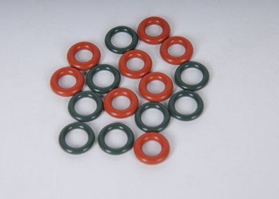

The problem is still happening. I found small vacuum leaks at 2 injectors and the MAP sensor so the ACDelco 217-3361 and GM 16194007 O-rings slowed down the misfire rate a bit. Still getting occasional P0300. Haven't done the sticky lifter test yet. Want to replace all the vacuum lines but having part number problems that I'll post in another thread.
http://www.amazon.com/ACDelco-217-3361-Original-Equipment-Multi-Port/dp/B00556TP0A
http://www.jegs.com/i/Chevrolet+Performance/809/16194007/10002/-1
