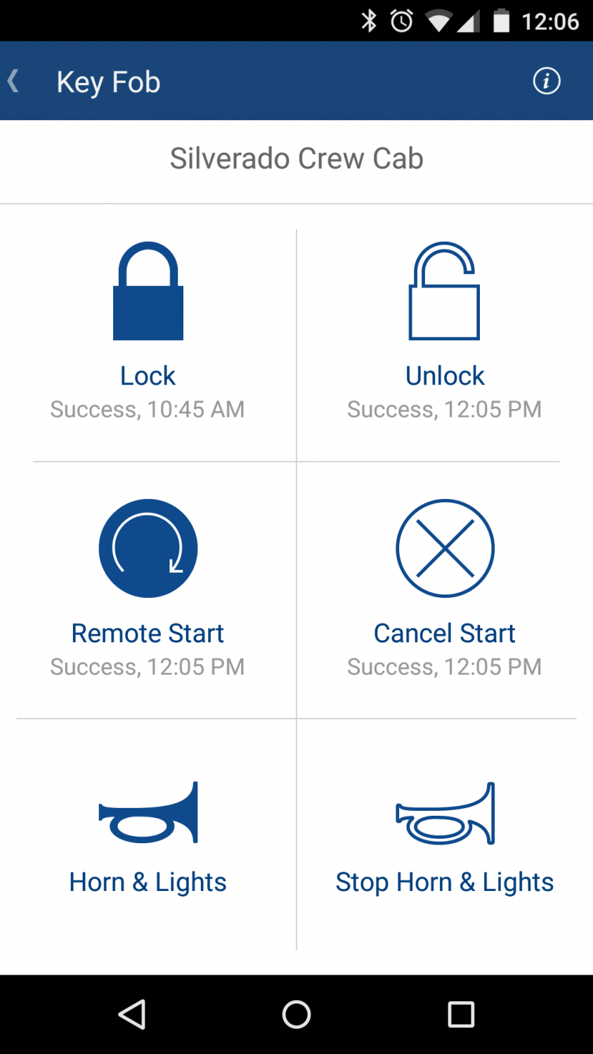

Bsbard, did you get it working yet? I called Onstar today and they once again told me it won't work in my truck. Which is a July 2014 build, 2014 Silverado LT. I even told them what the OP mentioned and asked to send my request to tier 2 support so they could program into their system. But the tier 1 guy said he checked and my truck is not capable. He said the dealer would either need to install a newer version of the remote start kit or possibly update the software in the truck then maybe it would work but there was nothing in their end they could do.....

Tier two support finally got my work order today, one week and several phone calls later. Getting past tier one support is the main obstacle, they don't have a clue. It has to be a tier two, offline technical support technician to reprogram their OnStar build sheet to match the dealer update when they activate the factory remote start. Should be active on my app in a couple of days.

An update on this. Onstar called me back today and apologized for them giving me the wrong info. She said she was escalating my issue to their senior support team and they'll be adding the code in their system to make it work. Hoping it actually does.
Finally after two weeks, OnStar got it updated. It's working now.

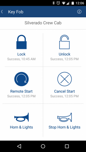

It looks like it's our lucky day. I got a call back today and my app now indeed looks like yours and the remote option works!
