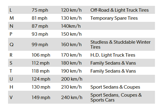

Just wondering why you would want a P rated tire when the BFGs are R or S rated.
http://www.bfgoodrichtires.com/tire-selector/category/off-road-tires/all-terrain-t-a-ko2/tire-details#techspecs

Not the speed rating - the P rating means passenger and LT means light truck
An E-rated LT tire will ride rough and they are significantly heavier than a P-rated tire, because they are built tougher and handle a higher weight/load.
He's referring to the load range.
Has nothing to do with speed rating, he means P275/55R20, rather than LT275/55R20 as an example.
