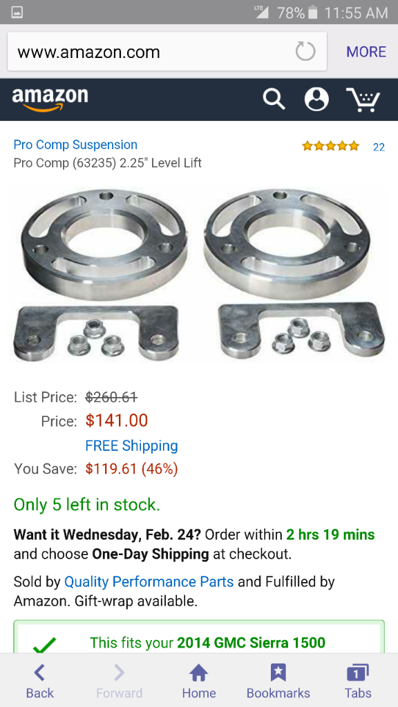

I'm not sure why yours look like that, now do you know if they installed the upper and lower strut spacers or just the lower it looks like it's only the 2 inch leveling kit to me and if u go on amazon they have the pro comp listed in think 150 or 170 not sure on the price and it's 2.25 inch ...good luck man

I called 4 Wheel Parts and they said that they installed the 2.25" level kit in the front and did nothing in the rear.
I recall my first sales guy telling me that the 2.25" kit was comprised of a 1.5" spacer and and .75" spacer for a total of 2.25". I asked if they possibly only put one of the spacers in and the guy I spoke to this time said it's only one 2.25" spacer and not 2 spacers. I hate nothing more than getting conflicting information from someone. Regardless who is correct they have someone working there talking to customers that doesn't know about their products.
