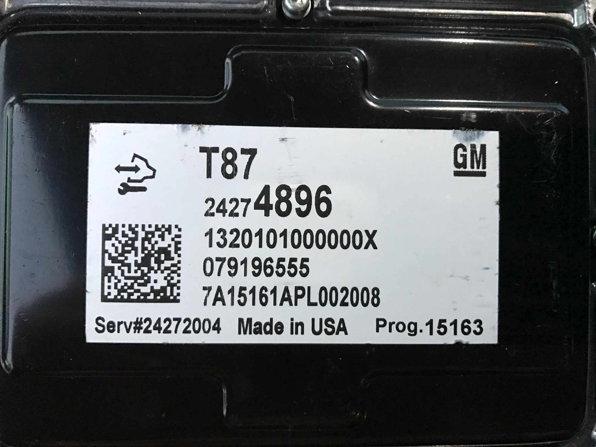

Blackbear sold me a 2015 TCM (The 2015 part # is 24274896) way back when. I don't know the donor vehicle it came from.

Picture of the 2015 TCM.
My spare tcm is also a T87, but the part # is 24276411. They said to get that part # it was one of two that would work. That's the only part # they told me. They also said that it had to be from a truck with a 6.2 8 speed. I just emailed them. Hopefully the process will work on mine and that I didnt buy a spare tcm for nothing.
Sent from my SM-G950U using Tapatalk
T87 is the TCM for 2016 and below.
T87A is the TCM for the 2017+.
Part # for 2015 TCM is 24274896
Part # for 2016 TCM is 24276411
Part # for 2017 TCM is 24279973
Blackbear told you to try and match the vehicle as closely as possible because of what happened with me (Sierra 5.3 8-speed with Sierra 5.3 8-speed, Yukon 6.2L 8-speed with Yukon 6.2L 8-speed, etc.)
