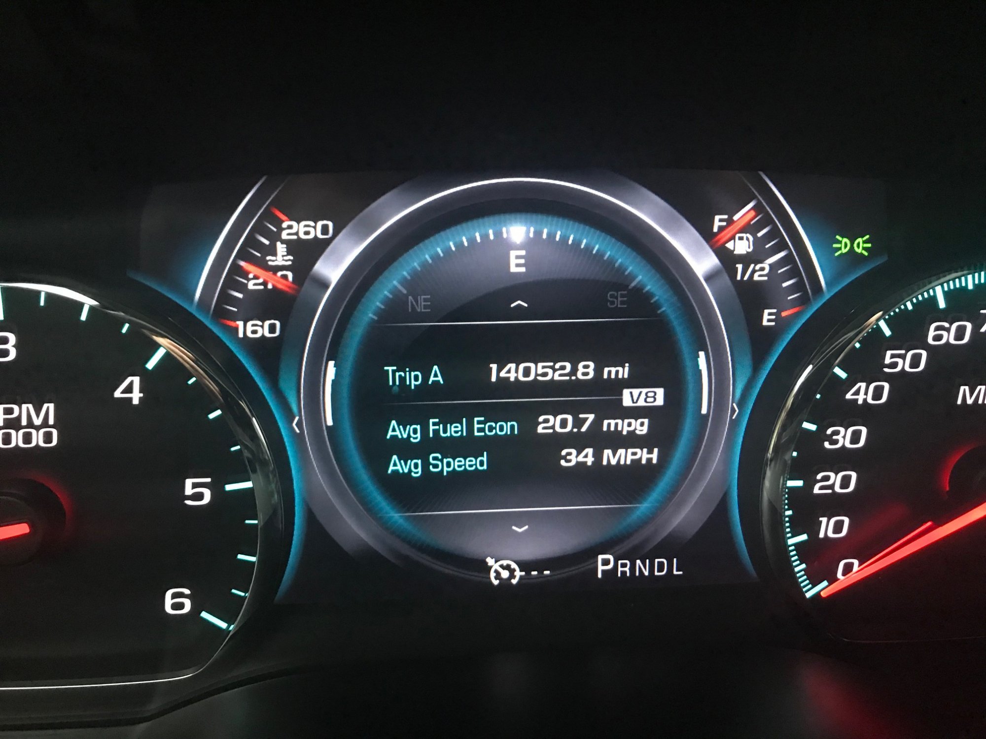

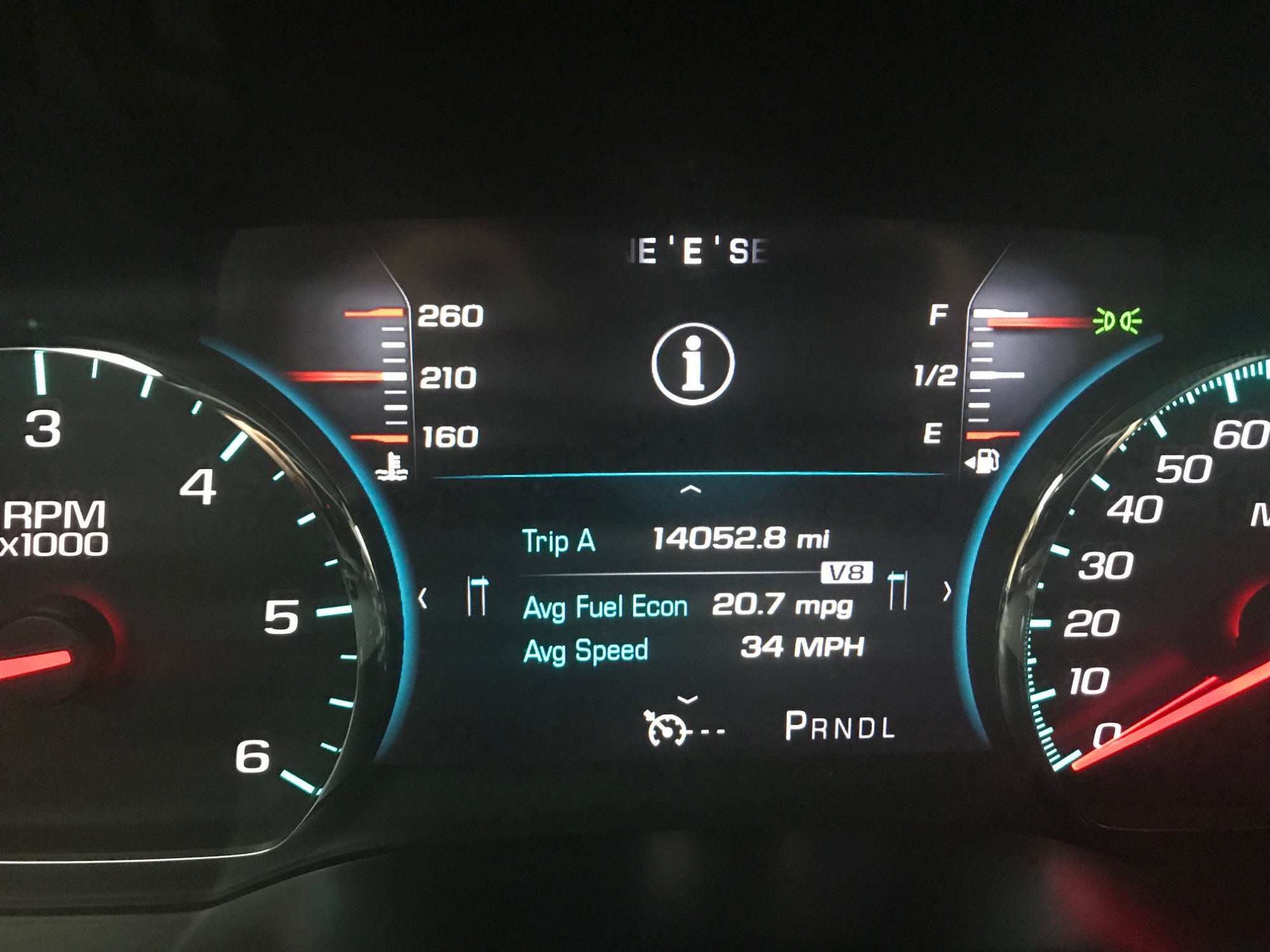

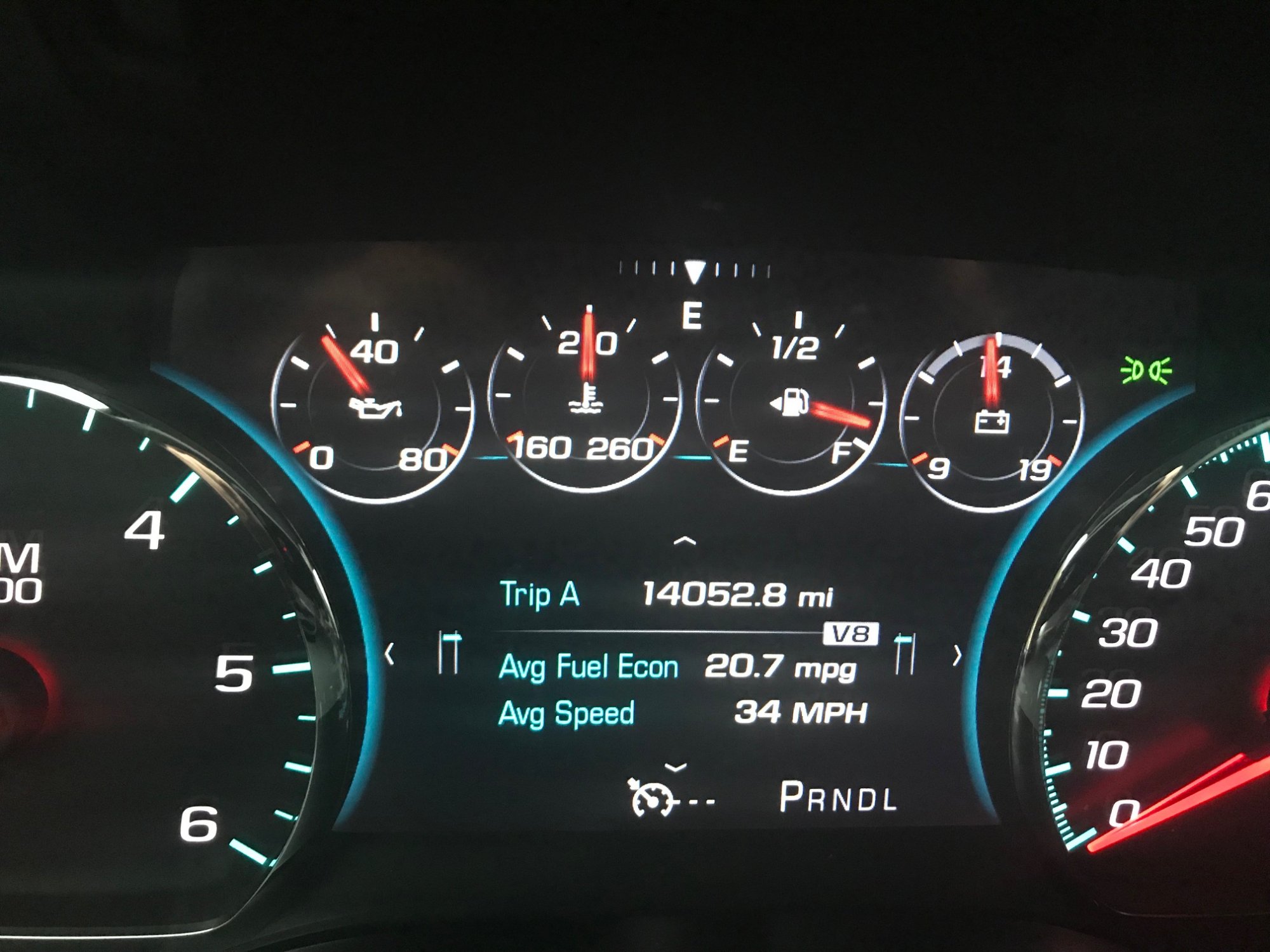

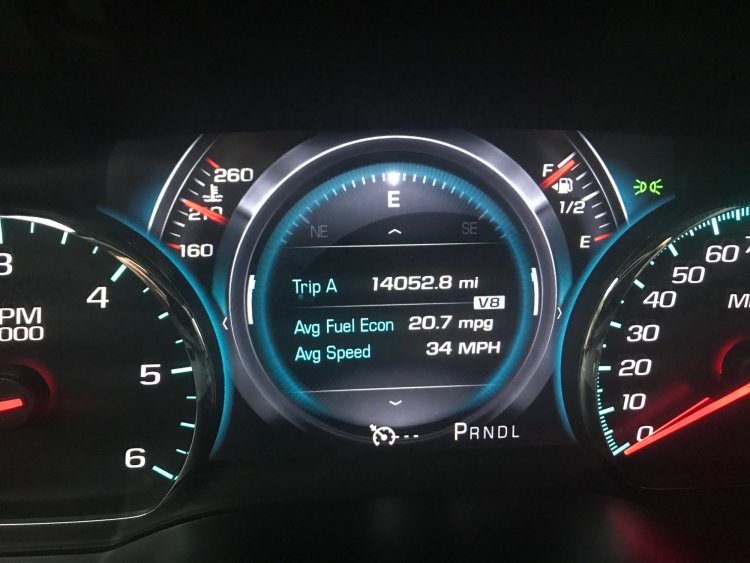

I want that Denali Cluster! I bought SLT for the Max Tow package and 3:42 gears. This is the one thing I'm missing! I've emailed Chris White http://www.whiteautoandmedia.com. They must be swamped, no response. Trying to find out what part number i need to look for to be compatible with my 2018 SLT. May have to wait awhile until 2018 Denali clusters become available. I see a few Yukon Denali clusters but i think those are different design than truck clusters.
  • 4 weeks later...
I’m subscribing to this thread. I have a 2017 5.3L All terrain with 8 speed. Absolutely love the truck. Currently has 47k miles. The only thing i noticed was a random clunk when it’s cold taking off.
Since i don’t have much warranty left, I took it to local dealership and they are pulling the transmission pan and flushing the system.
They put me in a 18 Silverado 5.3L 6 speed and damn I love my truck so much more. I love the 8 speed and I hope they get their shit together.
Everyone be sure to keep posting updates..
Yea I've been looking for a 2018 cluster for my LTZ 6.2 max tow as well. There are only a few numbers out for the 18s there is a list somewhere, not sure if it's been updated to include anymore numbers for the 18s or not
Let me know if you get any updates on part numbers or a response from whiteautoandmedia
