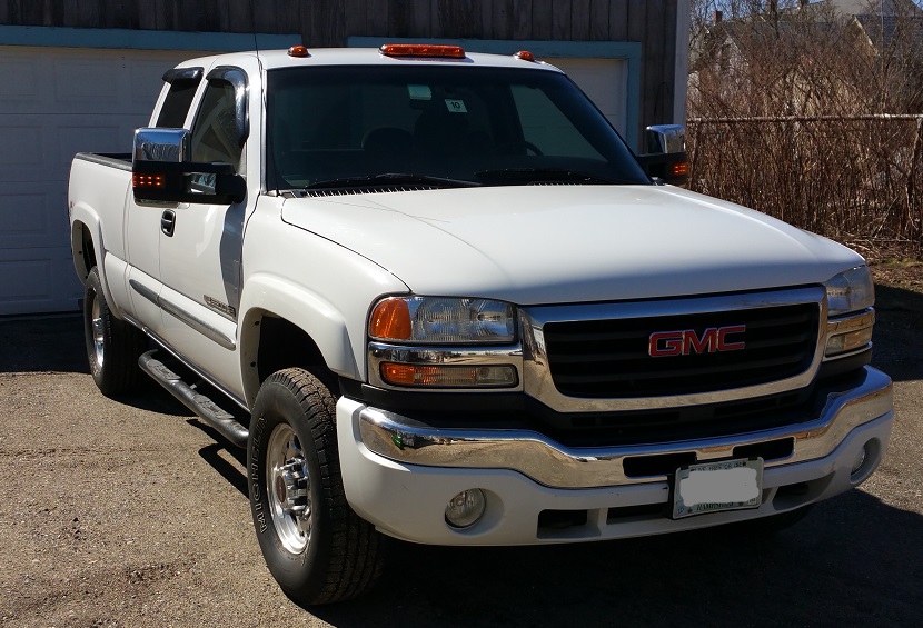

Installed the 01-07 version of these mirrors. They do Not come wired to work correctly, and actually need additional wiring to get all the way a factory set would work, they also have to be "leveled".
The are heated ( when rear defrost is on) , have turn signals in the mirror glass, are power on the top mirror on each side, and have reverse clearance lights on each side facing out and to the rear. Manual Folding, manual extendable. They Do NOT have a temp sensor in them, which many of the '14 and up trucks require. They were $200 on ebay and free ship at current pricing. If you want it all right, expect to spend a few hours.These are made at the same place the GMC mirrors are oddly enough. probably same shell and mirror glass.
