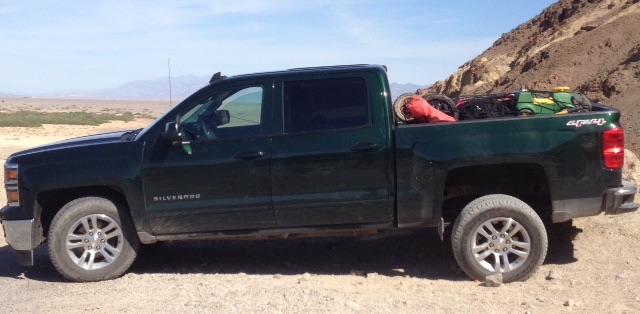

I just drove 1700 miles and 200 of it was off road with firwood and camping gear around 5-600#. the ride was super smoothe the whole way. Now that I am home and the truck is empty it seems to ride better. I really gave the suspension and tires a work-out on this trip. Posts of off-roading in the desert.
