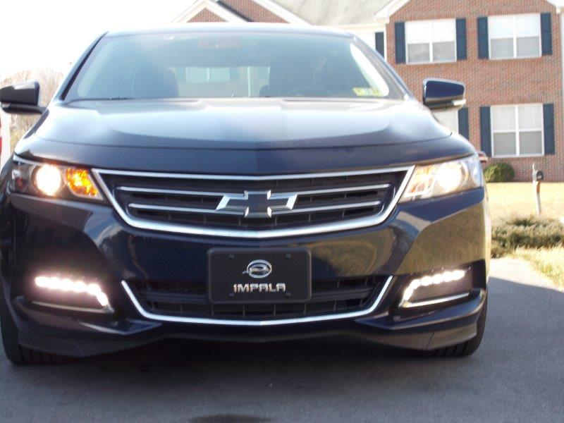

X2 on the LED fog lights........three stinking Luxeon LEDs per lens with a crappy reflector?.......they're just called fog lights so they can hit us with a charge for the option. The 14+ Impalas do not have fog lights but LED drl's on the LTZ version (like the Silvy's drls) having 6 of those LEDs. but they are no good as fogs because they dim when the main headlamps are turned on. Solution was to hook the six LED drls directly to a ignition powered circuit so that they are always at full brightness - And the six LEDs per side provide twice the brightness and do make a difference and the curved arrangement provides a bit of side lighting in a turn.
