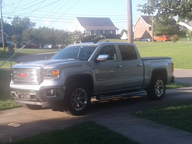

I have noticed I have a clunk noise coming from somewhere. Im thinking its coming from up front but not sure. Sounds like a suspension driveline or steering issue. Notice it alot while turning on uneven ground or when I swerve back and forth somewhat harsh on the road. Im taking it to the dealer this afternoon, just thought I might see if anyone else experienced this and has an idea. Truck does have a 2" level.
