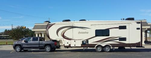

I have the Std sized bed in my 2016 HD as well I use whats called a Goose box for my pin box as opposed to the usual pin box.
The Goose Box allows me to use a ball hitch and safety chain anchors which helps me to have a normal bed. All the while keeping me within warranty constraints.
That being said, depending on the year and type of fifth wheel you may need a slider hitch to keep the camper from kissing the rear cab of the truck in tight turns, if you have the Std bed.
Here are a couple pics of the new rig with said set up.

I have been pulling a 30' 5th wheel for 10 years with 2 different standard (6.5) bed trucks. Most of the newer trailers built in the last 15 years have an extended pin box to help elevate any trailer to cab contact. I have a slider hitch that you can slide back about 10 inches when maneuvering in tight places. I have put my trailer in some tight spots and really only felt the need to use the slider a couple times. On my 2015 2500 the hitch is placed about 4 inches further into the box than my old 04 was. So far so go and no turning issues. My only concern is when hooking up the tail gate needs to be down and comes very close to the lower part of the camper but makes it fines with about an inch to spare. The truck just needs to be fairly straight with the camper or I need someone to lift or lower the gate as I pull in or out. Anything smaller than a 6.5 box just does not seem like it belongs on a full size truck..
