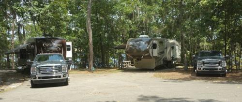

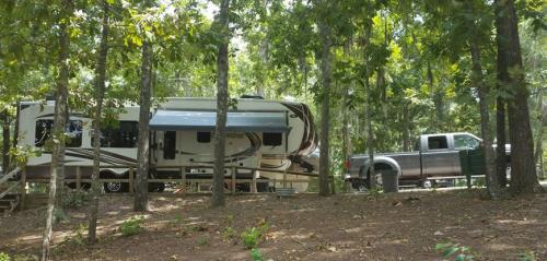

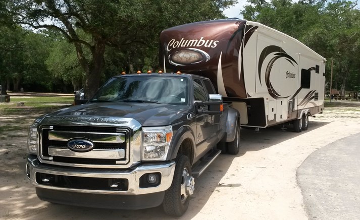

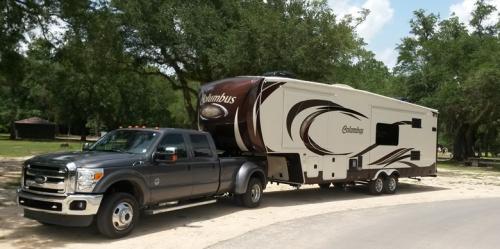

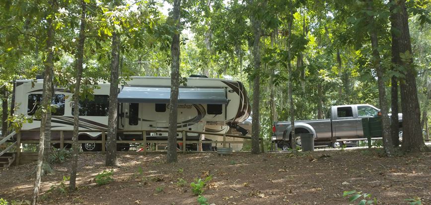

Here are a couple of the rig I just replaced.
The first 2 were taken on a trip with my sister and BIL. They have/had the black F350
Second 2 were at a local state park.
Last is the new ride.
