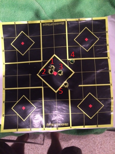

Here are my targets from both days. These are not all the shots I took since I was shooting at two targets both days. All shots were taken from sandbags at 100 yards, so my rifle was anchored solid.
This is Saturday's last rounds of the day
Shots 1 - 3 where taken with about 2-3 minutes between each shot to let the barrel cool a little. Each time I shot, the barrel was warm to the touch but not hot. Shots 4 & 5 were taken right after shot 3 and there was maybe 1 minute between shots so there was not much time to cool

On a second note, how are the groupings of my first 3 shots? Does it look like I'm dialed in?

Judging by your first 3 shots i probably wouldn't touch anything if this where my hunting rifle. You will never get more then 2 shots at something let alone 4 or 5.

As another poster said, if that was my hunting rifle and you were shooting at 100 Yards, I would not change it.
