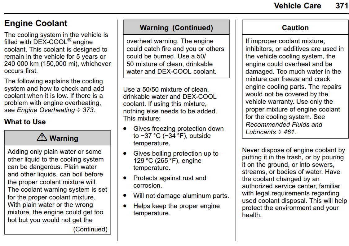

A local Chevy dealer I'm looking at charges an "anti freeze adjustment fee to take all the vehicles to -35 degrees below zero" as part of the title fees. Anyone ever heard of that? Aren't these vehicles delivered with a 50-50 coolant mix?

Never heard of any charges like that before, but then again I'm down south and guessing your up north somewhere. Others will chime in, but guessing it's legit?

I understand the charge but when I negotiate a price with a salesman, I don't pay a dollar more. In the past I accepted the extra charges and fees added on at the end but now I just give my final offer as an "out the door" price. I am not fooling myself thinking I am a clever negotiator, it is just that I dislike those add-ons! The upgraded anti-freeze is a necessity in colder regions. I once discovered this the hard way driving the Alaska Highway. Wind-chill will make your anti-freeze requirements even stronger than the lowest outside temperature!
