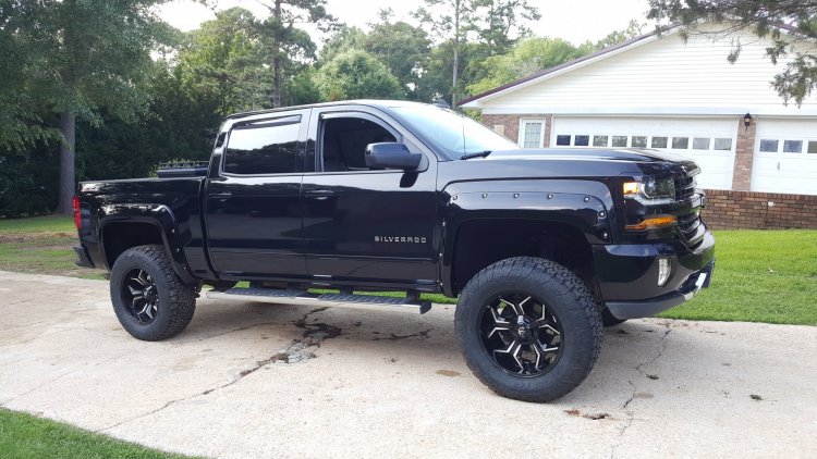

Hey everyone, so I just bought a new '17 1500, it has about 500 miles on it now. I just did a 2" leveling kit and put 275/60R20 BFG KO2s with new rims on it. I absolutely love this truck and how it looks now but, i have started to notice the Stabilitrak engaging the ABS on moderately aggressive around 90 degree turns, mostly left turns but some right turns as well. I did a bunch of searches but all i really found were threads from years ago and all guys with 6"+ lifts and 35s. This doesn't happen every turn and like i said it has to be taken a moderately aggressive speed and a pretty hard turn for it to engage, but its still pretty annoying.
I did an experiment and drove 4, 90 degree turns with everything on, took the turns fairly fast and it kicked in on every turn. Then i took the same turns with just traction control off, and it kicked in on all turns again. Then I held down the button and disengaged Stabilitrak, took the turns, and it never kicked in.
Basically I'm wondering, is there a way to fix this? Is it just the heavier tires and size difference throwing off the Stabilitrak? Has anyone else experienced this as well?
I haven't seen any threads about this topic from leveled guys so I'm hoping theres a simple fix, since it is such a minor level and only 1" tire size change.
