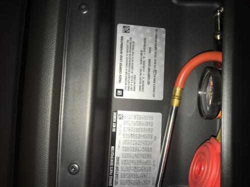

(1) Is there any difference in the axle - frame - suspension between the 2500 and the 3500? Or is it simply the tire/wheel rating. A dealer told me this was the case and I just am not sure. I am a little disappointed when I looked at the glove box sticker about a truck camper and it doesn't even allow 1200#.. Especially when the GM website specifies a payload of 2500#... I am thinking I can find higher rated E tires and wheels to allow me to at least use a 2000# camper... Maybe add some air bags.

Can you tell me what your 'camper' sticker in the glove box says? Just curious the difference between a 2500 srw and a 3500 srw, per GM anyway
I just looked in my glove box today. '17 ccsb 4x4 6.0, 1750 lbs in the bed. Must be the engineers leave another 1000 for people in the cab to max out gvw?
3192 lbs for truck camper on the glovebox sticker, 4024 lbs payload on the B-pillar sticker. It carries a 4,000+ lb truck camper as well as can be expected for a SRW truck.
