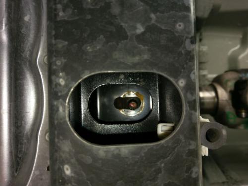

Wasn't the kit..Was this bolt in the picture posted...Is there a recall or TSB for this? If not, then the only other people to go under my truck was Firestone when i got my alignment done. Firestone dickheads drew this on the bottom of my car, did they also remove this nut to a tranny/motor mount?
Thoughts?

Would be impossible to pin this on Firestone but I know for sure it was Firestone...My car is kept in a secured underground garage at work and in my driveway which is gated at home. What I don't know is what happened to that transmission mount/bolt lol...Looks rusted and fell off...
Well it's at the dealership now, will keep you guys posted.
Problem fixed, dealer tech checked the mount and fastened it up according to spec, mount was fine. On another note, dealer used 5w30 instead of 5w20 on their "complementary oil change" ugh.
