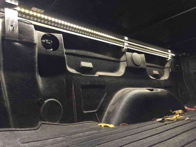

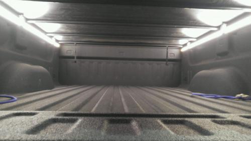

Oem kit has 2 leds on each side. 4 leds total. Plus the $80-130 price tag. Barely any light output. I got a kit from amazon for $19. Built my own harness and plug and have a ton of light. 4 pods on each side with 6 leds per pod. I just used the dummy plug that's already on the junction box.
0D01F813-4DF9-451C-A25B-D77C2283DB3D_zps
6ADE6939-CC7E-4FF0-B7B6-E7BB1DE26893_zps
EBEABEDC-90B8-464E-96B9-8D579C909C9F_zps
Pretty pimpin' - If you could post up that Amazon link it would be much appreciated......

my Midnight Edition came with bed lights. I added a 36" led strip to the front of the box and splice it to one of the bed lights . LET there be light. works great at night ,with tonneau cover
Kits to install the OEM bed lights are available on Fleabay for around $125. I bought one but was disappointed with the amount of light they put out . I went one step further and also installed a McTuning bedrail light kit from Amazon for $30. These are a great bang for the buck, good quality and VERY bright.
here:
https://www.amazon.com/gp/product/B01JUE9OLM/ref=oh_aui_detailpage_o07_s00?ie=UTF8&psc=1
I got the OEM harness from GM parts outlet (#22878806) about $30, LED strip lights from amazon and some automotive 3M tape. Saved quite a bit over what GM wants with better lighting.
Harness is plug and play, there is a spot by your spare that it plugs into and is controlled by the switch in the cab. Just cut the plugs off the light end and splice your LEDs into them. The LEDs I bought have adhesive but it's not that good. I ran the 3M tape where I put the lights, along the top of the rails. I'll try to take a pic tonight at work if I can.

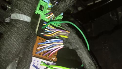

can you give me information on your dirode mod ???? Please
Basically you are jumping the #26 pin on the pink and brown plugs BCM under the dash.post-167554-0-13016900-1488993109_thumb.jpg
My truck came with them. I have a tonneau and like the factory integration (OEM plug and dash switch) but the light output is pretty bad. I will probably just buy LED strips from Amazon or ebay, cut the existing harnesses to remove the OEM lights, then splice the strips in. That way I will get more light but keep the factory plug and switch.
