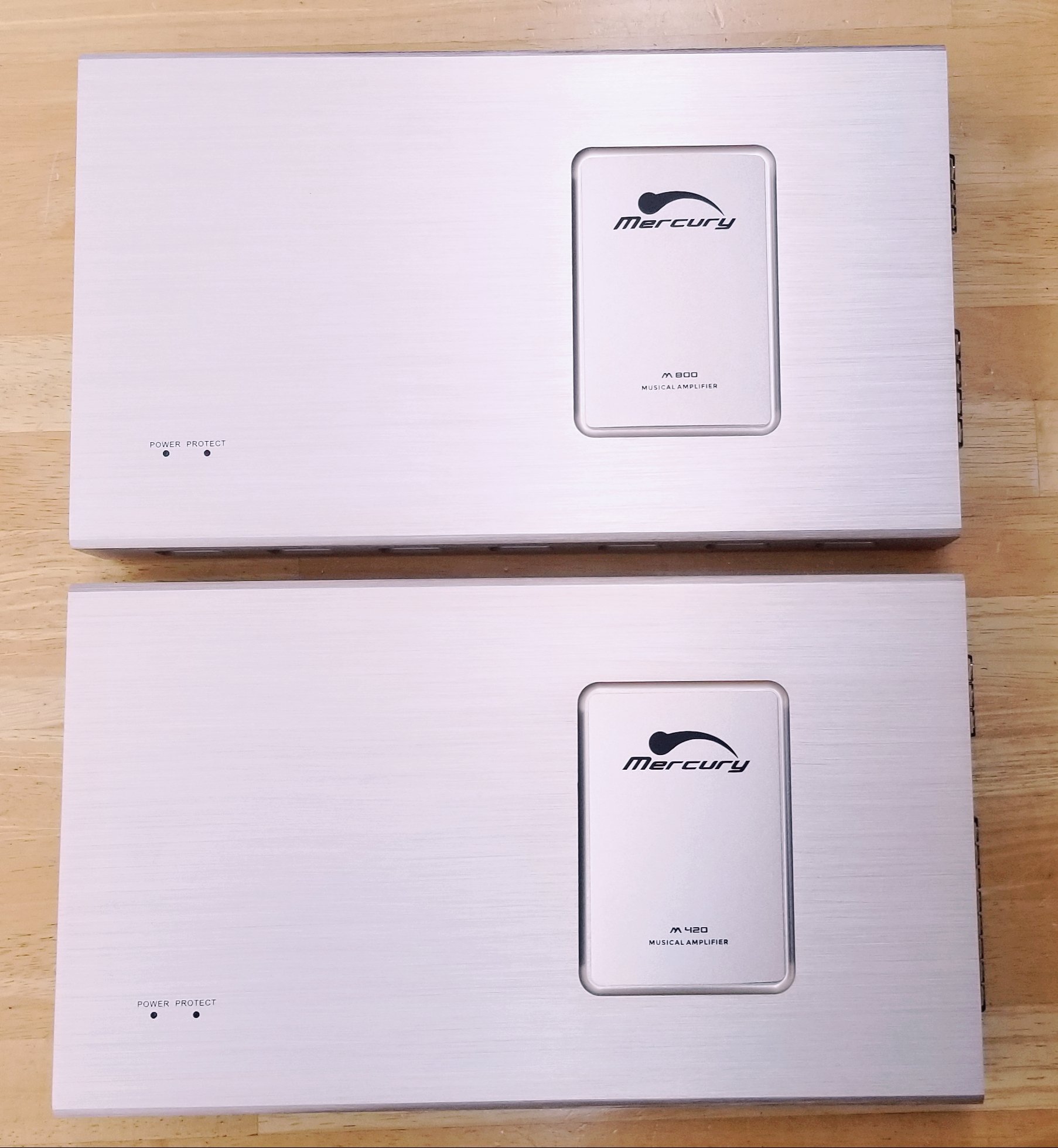

Look what happened to show up all at the same time

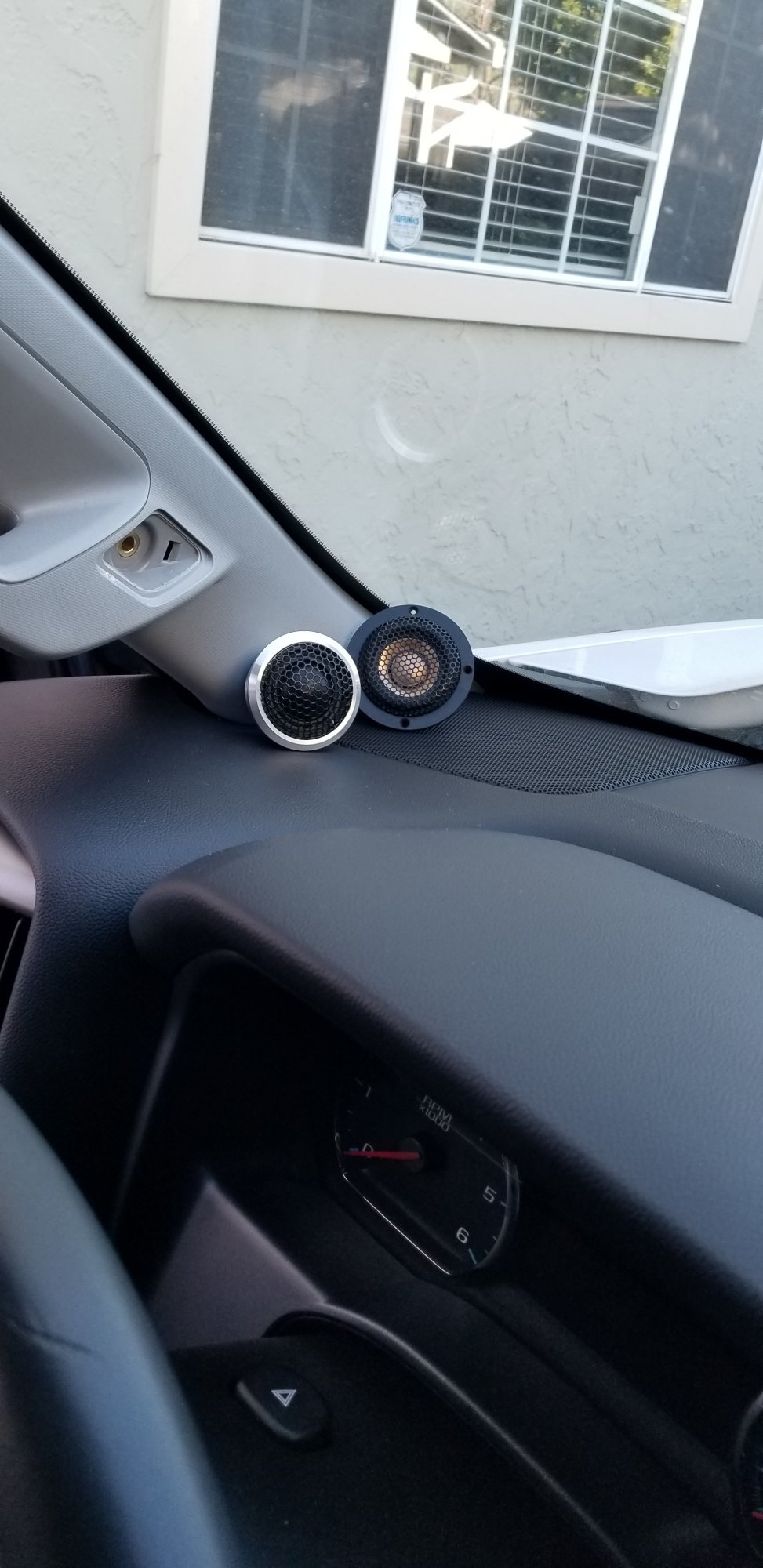

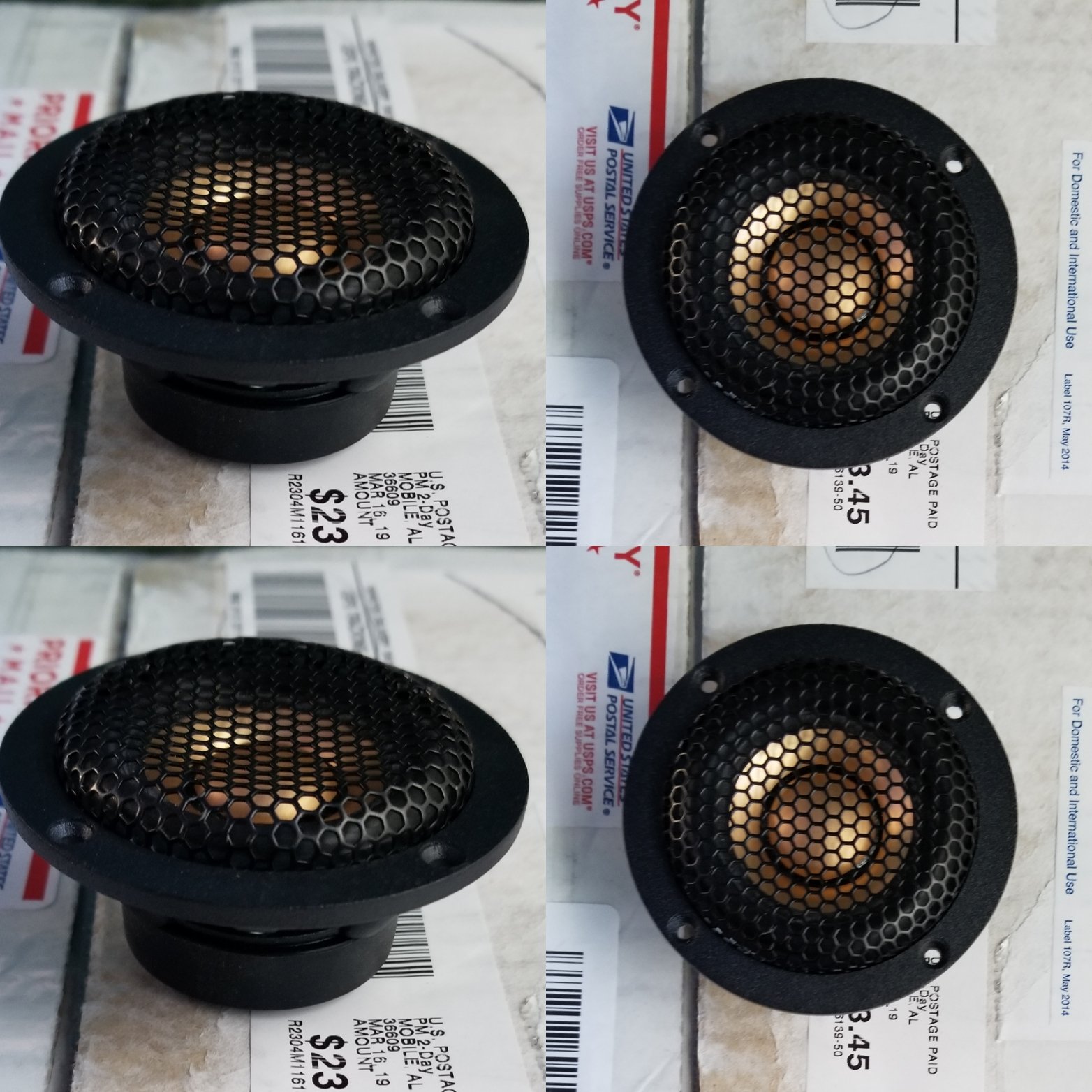

Well the midranges showed up. So im sending the pillars to my buddy for glassing and then the truck is going to me marv to finish.  I will be building the amp rack this weekend and mounting the amps

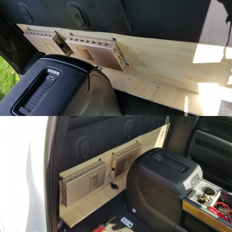

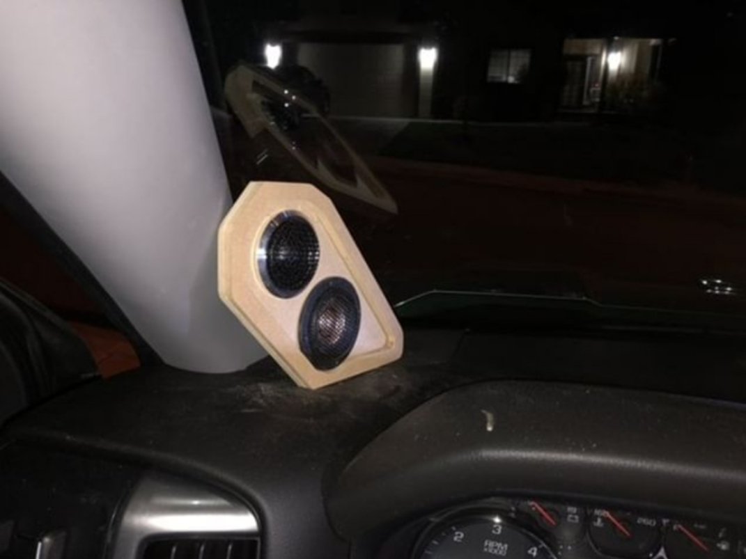

Started the rear wall amp rack. And the a pillars are under the knife
