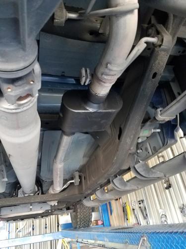

Hi everyone. I just bought a 2014 GMC Sierra SLE. I took it into an exhaust shop today to make it louder like my 2006 was. They ended up removing the muffler and it's a tad louder than stock, but still not loud. We tried it with a magnaflow muffler first and it sounded stock.
Tonight I crawled under my truck and it looks like there's still a resonator near the tail pipe. Would removing that make it loud like I want? I just don't want my exhaust cobbled together. Thoughts? Advice?

I ended up going the less expensive route and swapped out the stock muffler for a Flowmaster Super 10, resonator delete and tacked the valve open. It sounds way better than it did before and it's not too loud where it's obnoxious. Eventually, I plan on doing a true dual exhaust with the tips dumped down just behind the rear bumper on either side. But until then, this works just fine for me.
I had the Super 10 on my old Silverado, I loved it. I don't know for sure if I'm gonna back to it or just do Magnaflow or Borla.
just installed the super 10 on my 5.3... and dumped it before the axle....man its deep deep sound... like an old school muscle car... wife likes it too... it now sounds like a truck.
