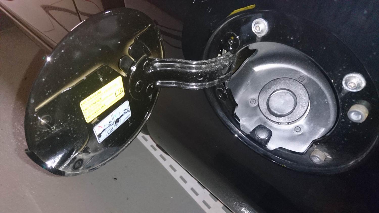

Was trying to find an imagine but if your truck is flex fuel the ring on the capless system is painted yellow.
Not on these trucks, Just a yellow sticker that says E85
Thanks for the info. I could have sworn the dealer I got my 2017 from had one with the ring painted yellow.
I really thought that's how it was going to be. I was really surprised when my truck came in and just had the sticker.
