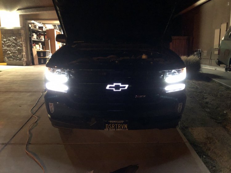

On 8/17/2017 at 9:29 PM, mtsz52784 said:
Just picked up my 17 Z71 with dealer installed, looks awesome.
Does the bowtie light up with the daytime running lights or just at night when the low beams are on?
Depends on how you wire it in.  I'm going to only have mine on with my headlights (low & HI).  The ones that I have seen, they're not as bright as they appear in pictures.
