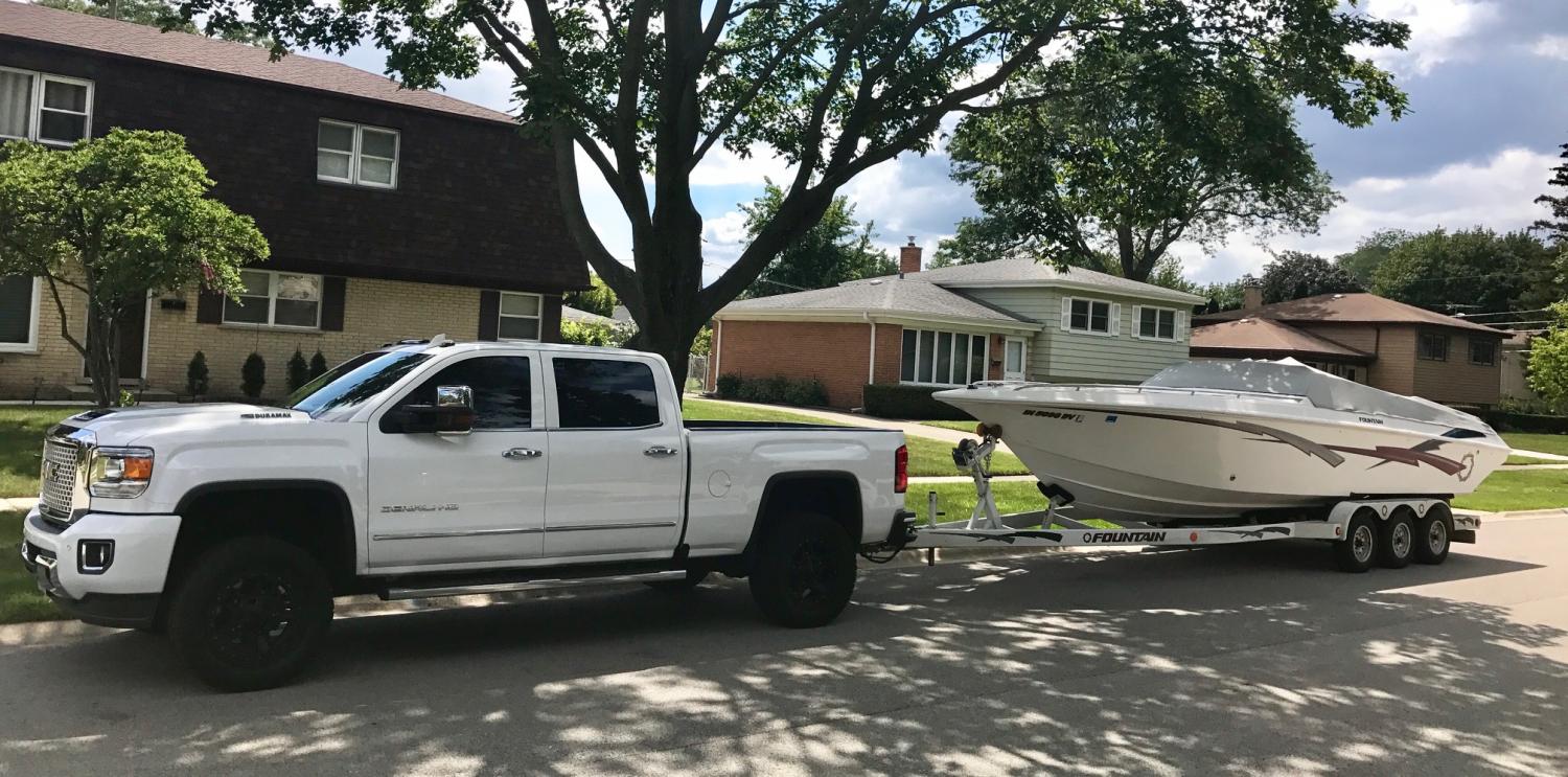

Here's the issue. I was told the truck has a leveling kit up front, but not so sure this is the case. This thing rides AWFUL. Front end bounces like mad. The main issue is when I'm towing my 29 foot Fountain Fever on a triple axle trailer and there's some load on the rear...then the front end bounces so bad on dips in the road its just brutal to the point of unloading the steering and giving us sore necks on longer pulls. Bit of reading I've done makes it sound like aftermarket keys wouldn't produce this bad of a bounce? Looking under there its hard to tell if they used keys as claimed or if they just cranked the living piss out of the stock stuff and re-aligned it. I'm leaning towards option 2, the front suspension just feels SO stiff and has no travel.
I am pulling my boat 8 hours end of next week down to Lake of the Ozarks shootout from Chicago, and really want to sort this prior. My first question is if as a short term solution, I drop the front end back to stock, do you guys think these tires will clear ok? I've seen some of you saying a wide 33" like these will clear with stock ride height. I'm assuming the negative offset on these wheels would further help that situation since it would be getting the tire away from the inner fenders. Given my shortage of time, I'd probably want to just do that for now to get the ride quality safe for towing, then figure out the right way to level the truck back out and not have it ride like poop and sag in the rear while towing.
I'll attach a pic of the truck as it sits, with my boat hooked up. Thanks alot in advance for your help!

Also does your rear end sag at all with this setup when you are pulling your toy hauler? as you can see in the pic, my truck currently sags some with the boat on the back.

The sag in your pic is what made me suggest the WD hitch. Even though your trailer might not be that heavy, the tongue weight is probably pretty high.

Sounds like it's probably cranked up as far as they could get it and the upper control arms have no downward travel before hitting the bumpstops. new upper control arms would probably make a huge difference IMO.
