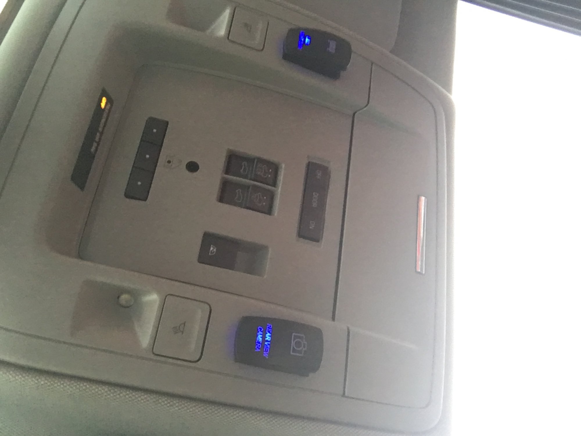

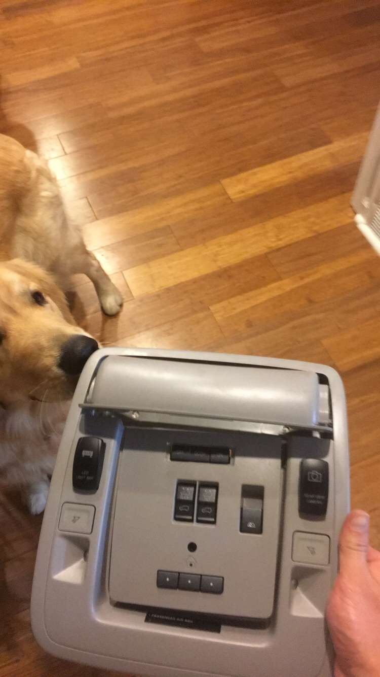

How are you running the wiring to the switches by going this route?
You will need to remove/pull back the front part of the headliner. You will then run the wires down the A-Pillar to your power source and accessory light.
I figured as much, just making sure lol thank you sir!
Correct take the a pillar off then just run your wires through headliner. I didn't remove the headliner just gently pulled the edge down enough to get my fish sticks in. It wasn't easy very tight but just go slow and it can be done.  I grabbed a key hot wire from the console so looks like this when the truck is on.  Also using this wire and a relay under the hood for the bar allows the Lightbar to only be able to be switched on when the key is on.
