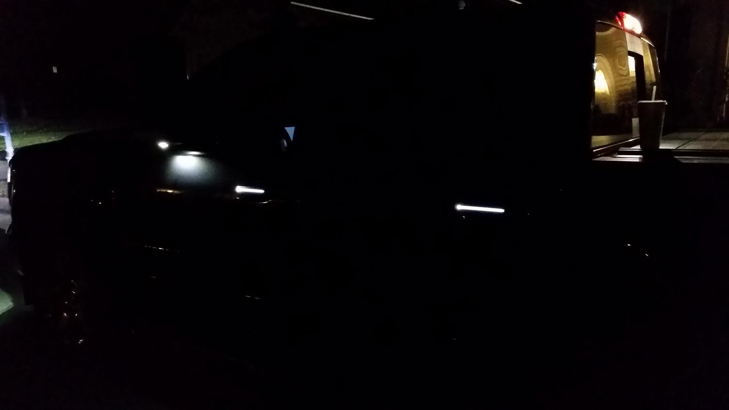

All done. Thanks to pgamboa for the writeup and supplies I needed to finish this.
  • Replies 121
Really happy to see others able to complete mods with my help looks great!
Still enjoying these handles. The lights are very subtle, but cool nonetheless. I actually like the contrast of the chrome, so I have no plans as of now to get them painted.

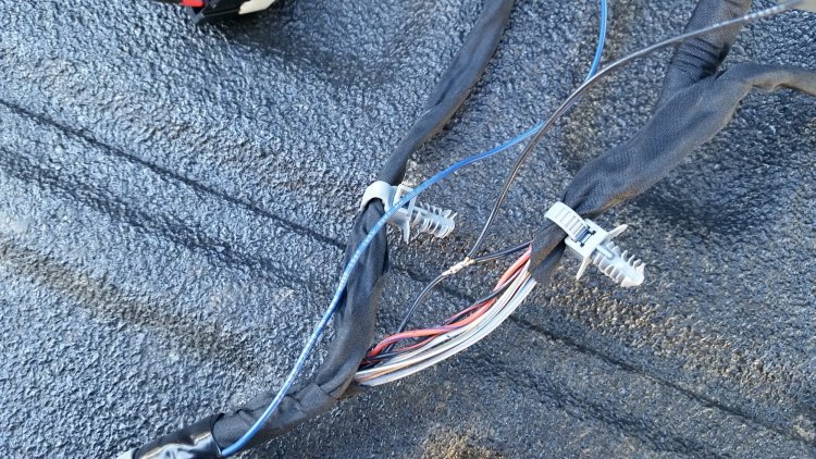

@pgamboa I pulled my door handle off the other day to inspect the wiring on my Yukon, but either didn't have enough slack or it was hung on something. I'm considering going the easy route and swapping in Escalade door harnesses. I've got the driver door on order to make sure it will work (I also have an ulterior motive to get the camera feed from the Esky mirrors to the door jamb connector). My handles arrive tomorrow...just need to have them painted.

Here's the connectors I used.  It didn't occur to me to check the measurements of the door opening prior to getting these.  I had to shave off the little tab in order to get it through the door.
@pgamboa I got the driver's Esky door harness installed and everything functions properly. The only difference I saw is the connector for the door handle. It's keyed differently than the one on my OE harness. However, it does fit the Esky door handle connector perfectly.
Esky harness on top
You can barely see the difference in keying. My OE one is the closer to you.
Esky door harness with my OE Yukon handle connector.
Esky door harness with the Esky handle connector.
Esky harness on top
Very nice! Looks like I wasn’t far off with how GM did it and how I did it :).
Very nice! Looks like I wasn’t far off with how GM did it and how I did it [emoji4].
Other way around sir! Gm wasn’t far off from how you did it!!!
