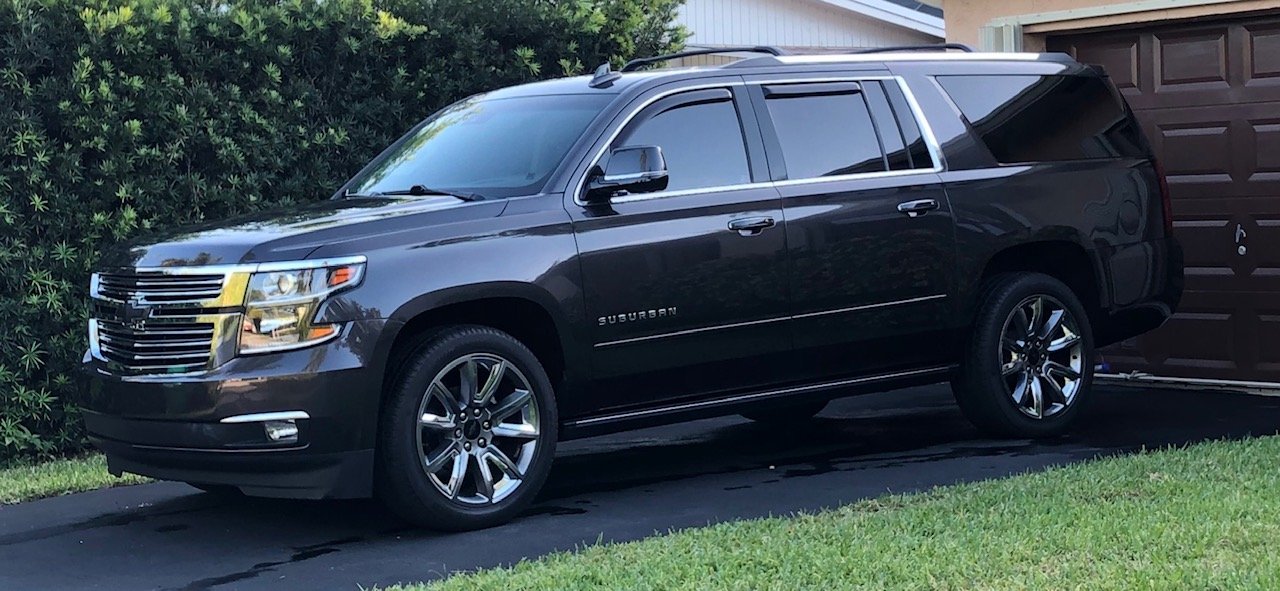

I have a suburban 2016 LTZ, I send a photo.

@pgamboa, I don't mean to insert SUV talk into this truck thread, but wanted to add some info for those that have asked about it.
As I'm sure Phil has mentioned previously, there is no factory version of the illuminated handles on a Silverado/Sierra.  Make sure you touch base with him via his website at www.harnessdr.com to discuss your options.
This is a factory option on the Escalade SUVs.  To add them to a Suburban/Tahoe/Yukon, there's wiring in the cabin and doors to verify and add.  It certainly can be done (I've added them to my Yukon) and there's a couple different ways to go about it.
To avoid confusion with having SUV info in this thread, send me an email to [email protected] and we can discuss the details for your specific SUV application.
