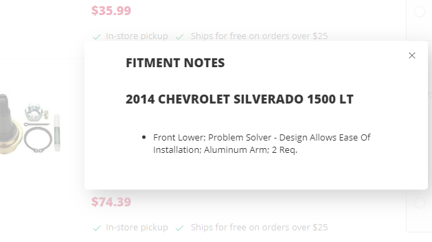

P.S. - I do see that Advance Auto Zone has a Moog Lower Ball Joint specifically noted to fit "Aluminum Arms" -  Does this mean that it is possible to replace the lower ball joint on my aluminum control arm with a normal Ball Joint press?  Will I need some type of special press to handle this  without deforming the control arm itself?  Moog Part ##K500245

Pressing out a ball joint from aluminum arms is no different than steel arms.  The A-arm should be supported as close to the ball joint as possible, all the way around and square-level.  You can heat the aluminum to 300F if you want to make it easy to remove/install.  No more than 300F .  A hair dryer will work. Aluminum grows/shrinks at a much higher rate than steel ball joints.

Sorry I thought I mentioned it in my other post LOL.  The joints are removable both lower arm designs.  No need to change the whole arm.

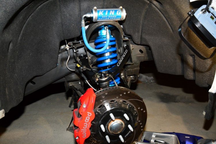

Good to know. It looks like you have a pretty significant rig on your truck. Do you believe the cognito arms or the rough country arms may have worked on a stock strut (I believe the Rancho stuff) with just a top spacer for the level?

1 hour ago, triple-tap said:
Good to know. It looks like you have a pretty significant rig on your truck. ...
That was not my truck.  It was a web picture.
This is my truck
...  Do you believe the cognito arms or the rough country arms may have worked on a stock strut (I believe the Rancho stuff) with just a top spacer for the level?
For what I know about what Rough Country sent, I would say the A-arms they sent me would have interference regardless of what type of level or stock setup.  Hopefully they changed their design.  I don't know.
The Cognito arms had similar interference, but not near as bad.  My Cognitos still rub when the suspension is under compression.
