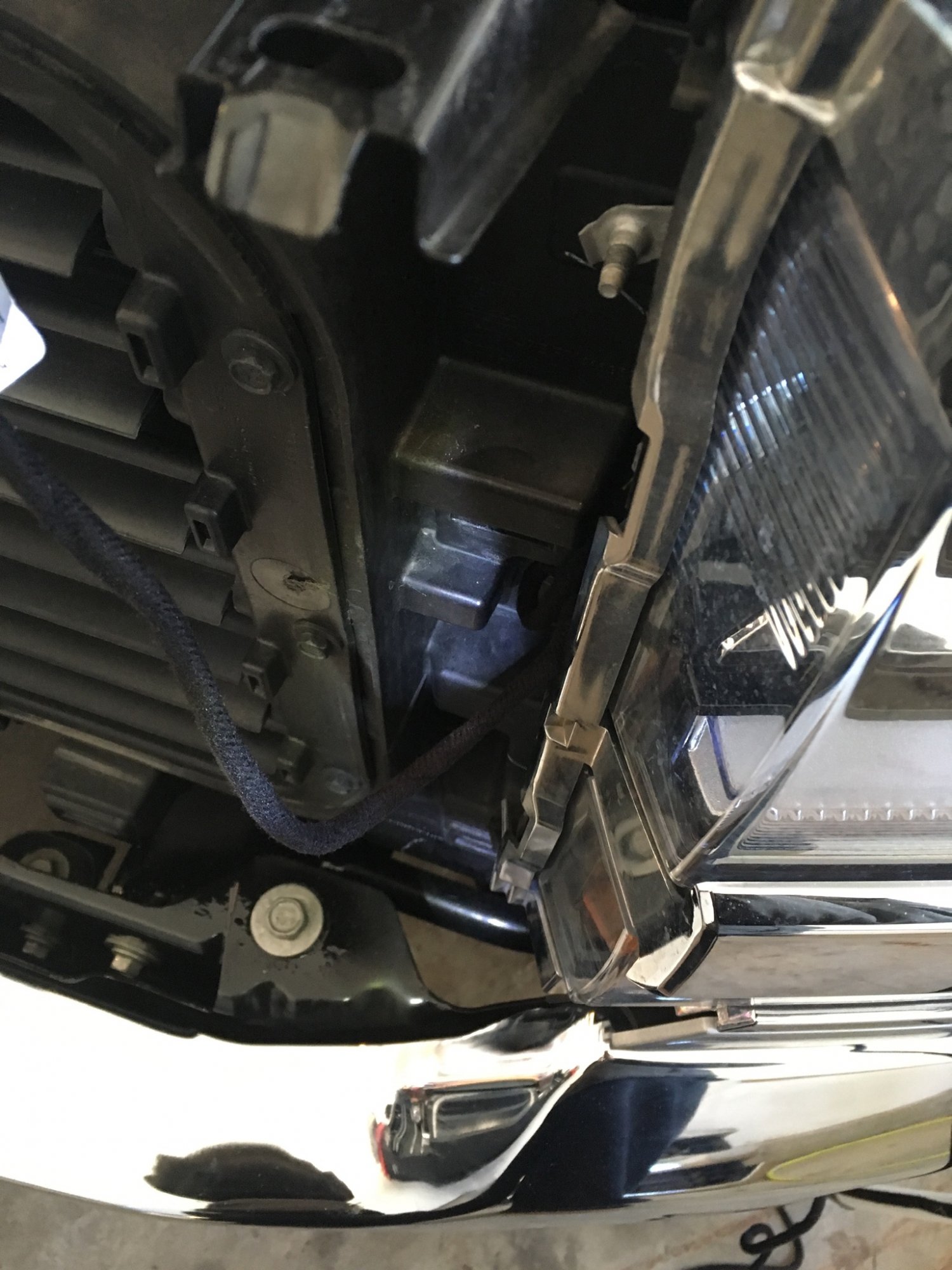

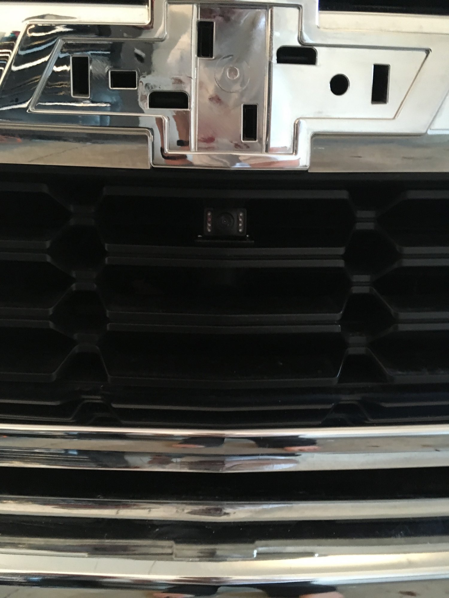

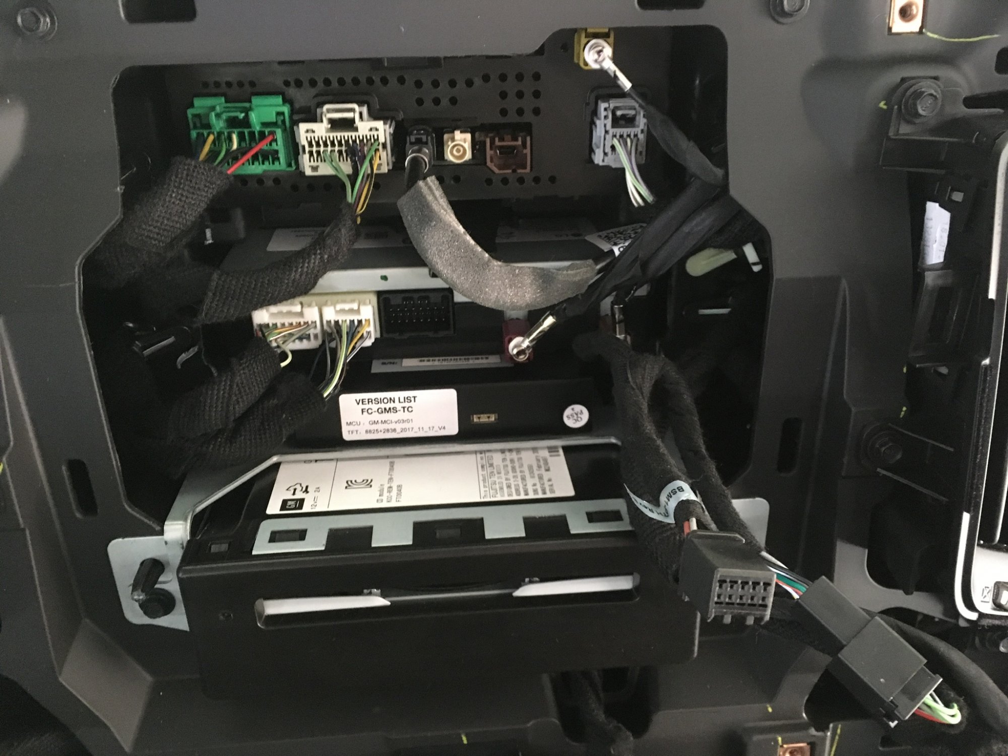

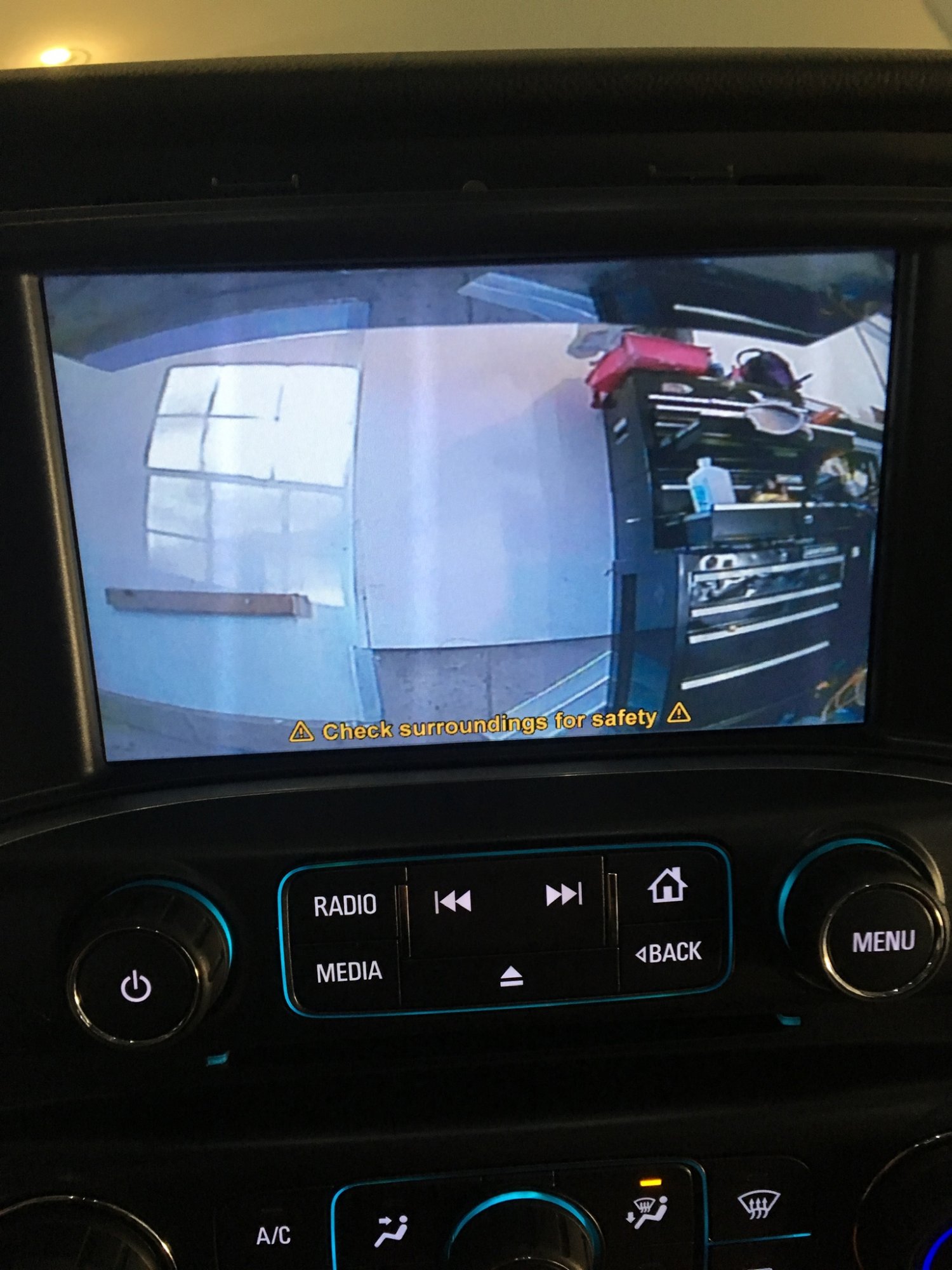

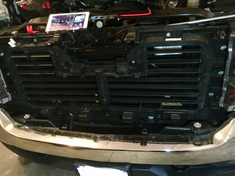

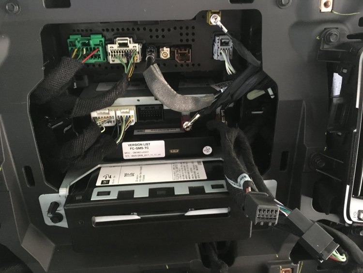

Finally got around to installing the camera, and the biggest PIA was feeding the camera wire through the firewall. It’s almost impossible to do with one person.  I had to use a wire running rod, and lube that up to get it though. Lots of repositioning and fidgeting to get it through. I also had to loosen what I think is the junction box in order to get my hand up behind it and pull the wire down. I finally had to ask my wife to help push on the wire as I pulled. It was not pleasant. The rest was straightforward. One note to tell anyone of you mount where I mounted, you’ll have to flip the camera so it isn’t upside down. I didn’t want to mount it hanging under the bow tie, so I mounted it upright one tier below. Anyway, here are some pics from the install. Getting the grill off was a little tricky as well,  so take it easy with that to avoid breaking anything.  If you have questions, let me know, and I’ll help if I can.

In the 4th pic you can see the module that’s mounted on top of a bracket over the CD player....completely plug and play with all connectors included. It’s actually a GM part number. Warranty even states 3yr 36k from date of purchase.
The other things that’s nice about this is all the connectors are there to add the  additional cameras should you choose to. There are several more available....the tow mirror cameras might be in my future.

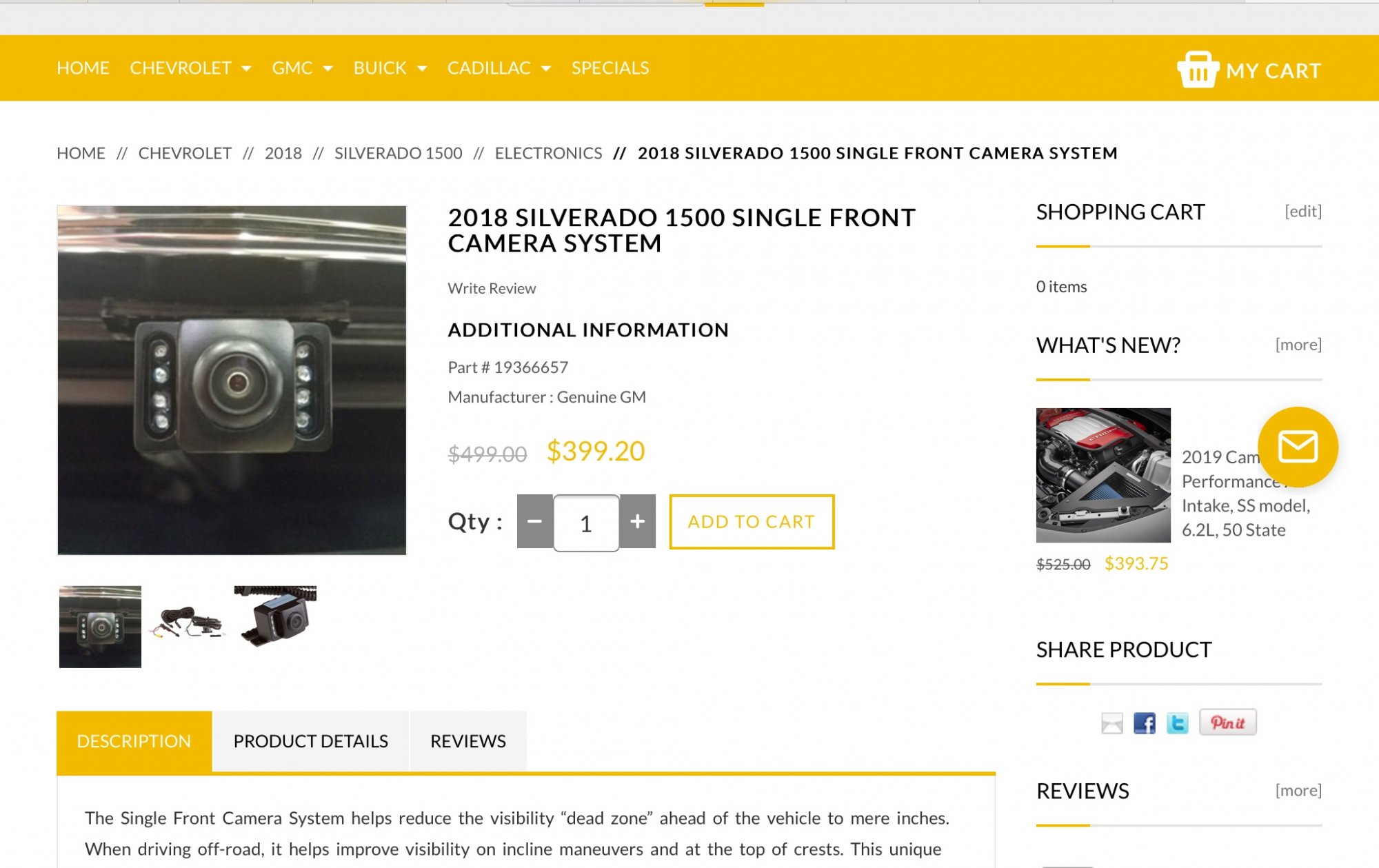

This is the kit you’ll need. Used their 5% off coupon, and got it for 396 shipped. I just liked how it was a GM part that was plug and play with the option to add all or a selection of the other cameras available.
