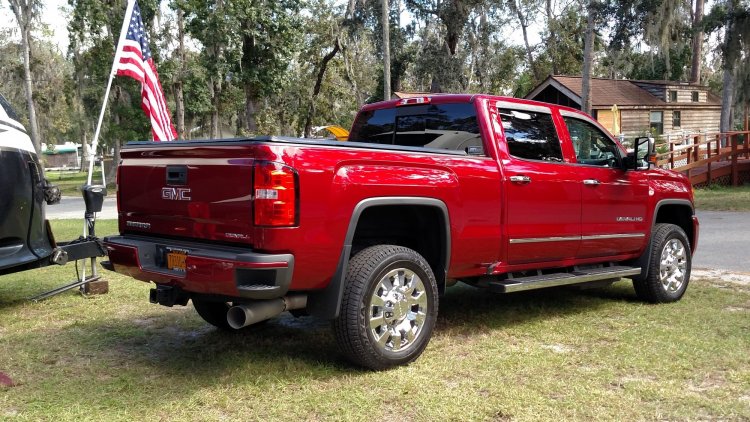

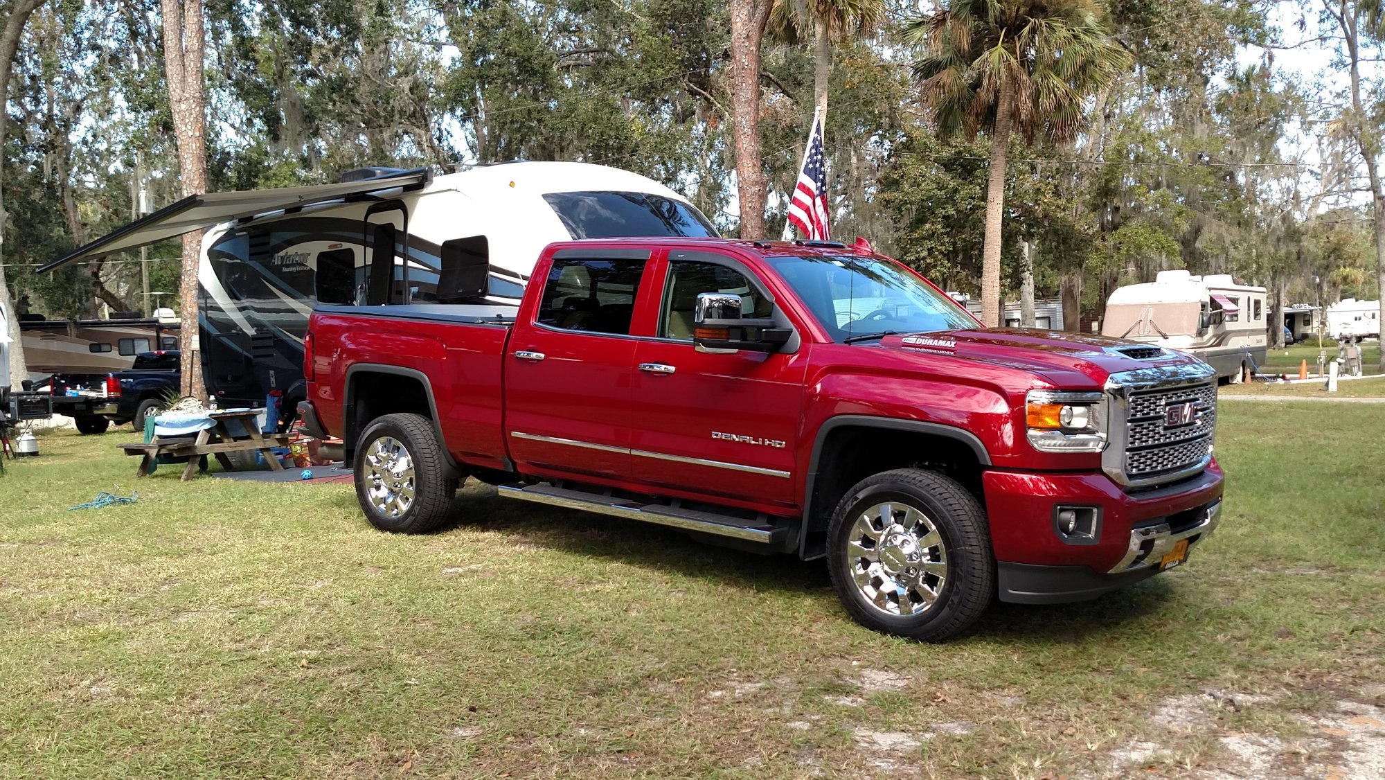

Installed 5100 rear shocks yesterday.
Amazing how much smoother the rear is.
I tried the stock Ranchos towing this trip to Fla, way too much vertical bob towing
Sweet looking truck, love the color. I have close to the same vehicle only gas dlb cab. Looking to do this for same reason. Towing can get use bobbing in the cabin on rough roads. You have a 5th wheel or tow behind?
9000# tow behind, Blue Ox hitch set up properly no sway
My '17 was Crimson, this is called Red Quartz its brighter
