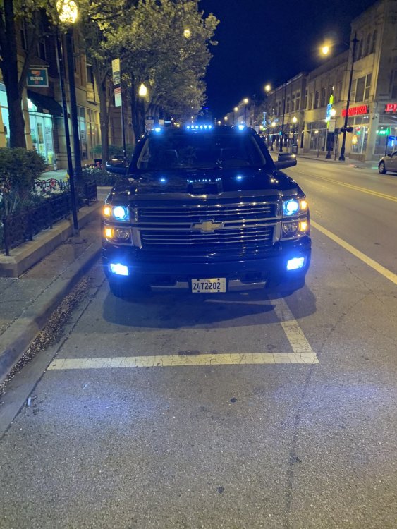

Cab lights done
Jaychevy81
looks great and like most others I wish I could do this mod im too scared to cut my roof up haha

I’m gonna be honest that wasn’t hard at all dremel with a cutting wheel cuts through like butter. The hard part was getting everything square.
You make it sound as if you didn't use the wiring harness, as you didn't have power in the passenger side fuse compartment.  But doesn't the harness allow you to connect to the 3 lightheads then at least have the lead to come down the A pillar?  Otherwise, with the short leads from the lightheads, you'd have to MacGyver something to make them work.
Right I used the harness basically for just those 3 plugs which was def easier. But at a 100$ I thought it would just plug in so I ended up cutting the plug off anyway.

I have all the part numbers for everything if I had to do it over I would not have spent the 100 on the harness. Yes it was def easier but it wasn’t plug and play on my truck. If you wanna do it. Open the passengers side fuse box and see if you have power to the third pin with parking lights on. After I had everything set to install I said let me check no power to that pin. I had to tap in to the parking light wire in the kick panel. So I had to make my own harness anyway.
If you're still here can you explain or post a pic of the wire you tapped?  Im about to install cab lights on my 2017 Silverado (I've done several cab lights from scratch installs) and will check fuse box but if I need to Id like to know which wire to tap(running lights)  Thanks.

Htttrh, I'd suggest getting the wire harness to make it easier.  It'll plug into the large opening in the left side of the passenger fuse block then it has the snap fittings for the lights themselves.

So my question is does the lights have to be on a switch if you connect to the 3rd pin or will it go on with auto lights.. I have 2015 high country 1500. I installed and wired them but I like run it to the fuse panel instead of tapping into the wires.. I have power to the pin
Look's Good . Is it me - Are your lights white ? they look light blue ??
