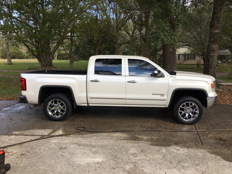

Running 2.5” leveling kit upfront and 3” rear blocks along with a 275/65/20 tire.
Running 3” blocks in the rear without any other modification will effect rear shock travel... Two different ways to combat that in the rear:
Option 1) rear shock extension mounts and stock shocks.
Option 2) replace factory rear shocks with longer aftermarket shocks that are designed to operate in conjunction with 3” blocks.
I went with option 2 because I didn’t like the idea of the extension mount. It’s honestly just a relocation bracket and in my option it adds a place for movement and/or failure compared to the factory fixed mount.

Looks good. What shocks did you go with
Running RC’s nitro shocks that are designed for a 3” block

I have the Bilsteins 5100 ( adjustable) maxed in the front. Raised it about 1.75" and 3" blocks for towing heavy trailers. I also replaced the factory rear shocks with 5100's and rear extensions. The RC extensions are very heavy duty and send like a solid install.
Just realized the pic I uploaded was a photo edit trying to see what a black Z71 grill would look like lol. Oh well you get the idea. 52337b86d07e1b254dfb2ca0b9f0845a.jpg
